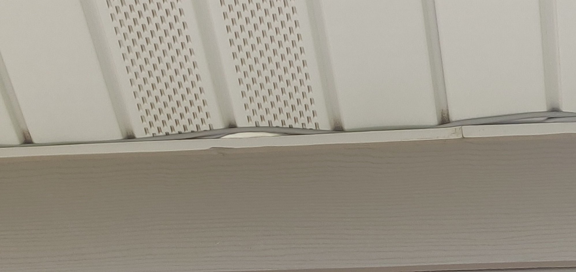

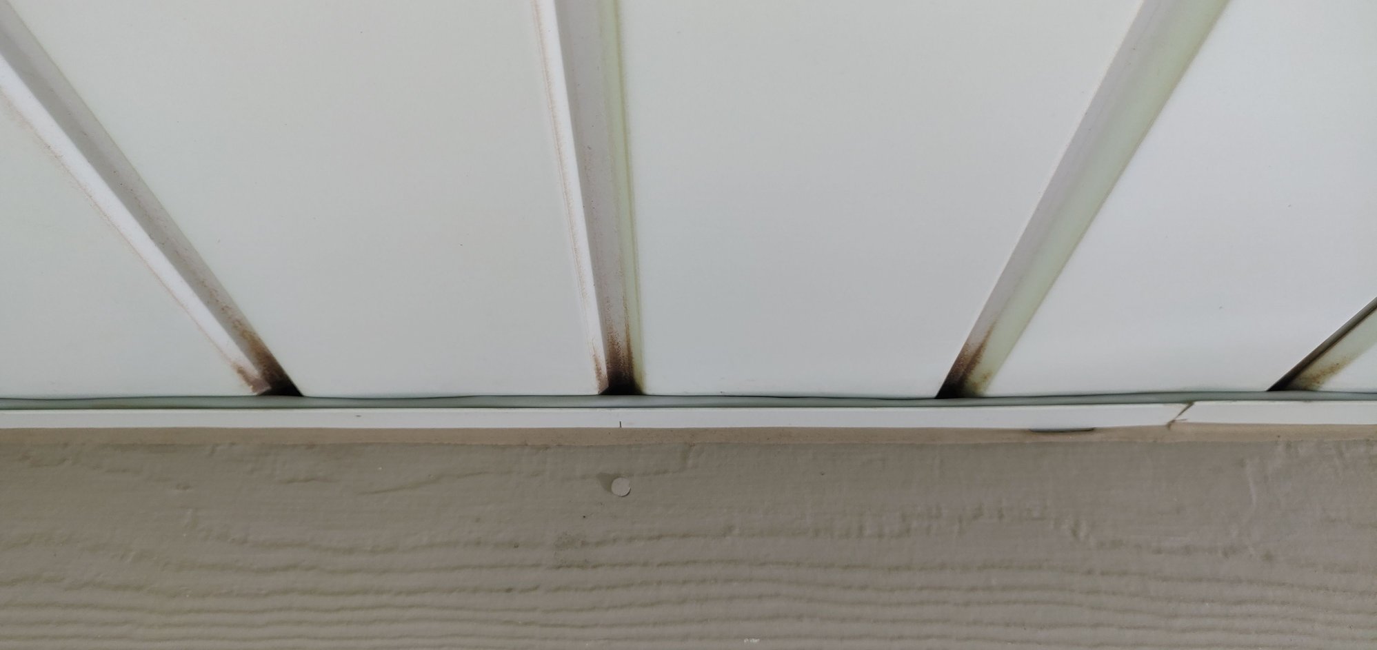

Posting a few pictures to show what my issue is., and I have to make sure they do not catch the wind and stay secure .Considering doing a screw in clamp , but really want to try to avoid drilling holes into siding

There may be enough room to actually push the cables up into the soffit.

The soffit is flush against the back side of the siding. maybe only 1/8 inch gap inside most areas. It was exact measurements when done. The only room I have is the 1/2 inch on the edge of the soffit rim. This is what I was hoping to somehow connect to. There is also no room to push up the soffit besides maybe about 1/2 inch upwards.
Cramming a lot of cables in the edge bends the rim slightly because of the pressure pushing downwards.

I install a lot of cameras under the soffits. I will bend that metal that holds the soffit and actually pull a piece of the soffit out. Then I drill from there up into the attic. I like when I have to put cameras at the corners. I'll remove a piece of soffit at every corner and using my fiberglass snake.... fish from corner to corner.

Thanks for your help. I found some zip tie mounting bases. This may be the best option for what I need.
