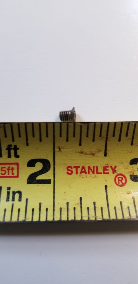

I am looking to get another screw like this one. I believe that it is made of brass. This one is used to connect a plate on a purse clasp, but its peer went missing. It is a Phillip's head screw. Any help is very appreciated!
Try McMaster-Carr, Fastenal or you can search Amazon. The first step will be identifying what you have. You will need to know the diameter, the number of threads per inch and how long it is (grip) or the metric equivalent. My guess is it is a #2 but it will take careful measuring to know.
Visit a big box store. They have screw templates that ID screw size, pitch etc. Once you have that figured out you can easily find a replacement altough you may have to cut it to the correct length. Option #2, if you have a real old school hardware in your area, they can hook you up.
I can't tell, even enlarging the pictures, but that screw may have an undercut head. They are used to secure thin material when a standard flat-head bottoms out "early". I wouldn't be surprised if it is literally an odd size, like a #3.
