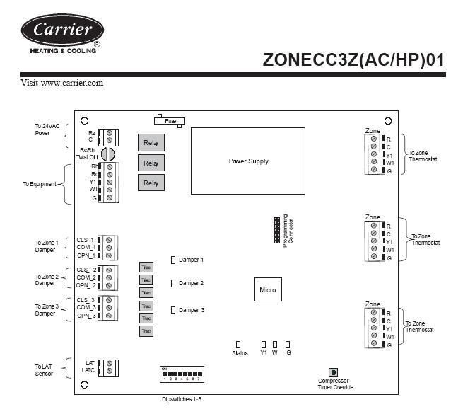

I went in the attack and looked at the system. I notices it has a 3 zone computer board. I was wondering if it could be the board and one of the zones (downstairs) is bad, could I utilize that third zone to bypass the problem? How would I figure out if it's the damper, the motor or the board itself?
Your zone control board sends a timed (about 20 seconds) 24VAC signal between Com2 and OPN2 when a demand is created in that zone. If you measure while someone pegs that zone stat it is much easier to check.
It is going to be the damper actuator. The bad news is that they change the damper shaft regularly so replacement of the entire damper is often required instead of replacing only the actuator which would be much less work. (this drives me nuts
You can unwire the damper and press the manual release button and spin the damper shaft with channel locks to the open position untill repairs can be made if my post proves to be correct.

Well, I replaced the damper control module (DCM) and gave it a trial run and everything worked as it is supposed to. However, a day or so later it returned to it's old ways. Bump the thermostat up from downstairs to activate the heat pump and the DCM fails to close off the upstairs ducting which results in 90% of the heat going upstairs. It runs for hours, heating upstairs to 80 degrees and never really heats the downstairs area...
I noticed I have a 3 zone circuit board and was thinking about abandoning zone 1 which controls the upstairs DCM and utilizing zone 3. Question: is there any reason why the system wouldn't work properly with zone 2 wired to the upstairs thermostat and zone 3 wired to the downstairs thermostat? (instead of zone 1 wired to the downstairs thermostat) Zone 3 is currently unused...
2nd question: Is there any indication that the thermostats could be involved here? They seem to be working as needed but I'm grasping at this point.
