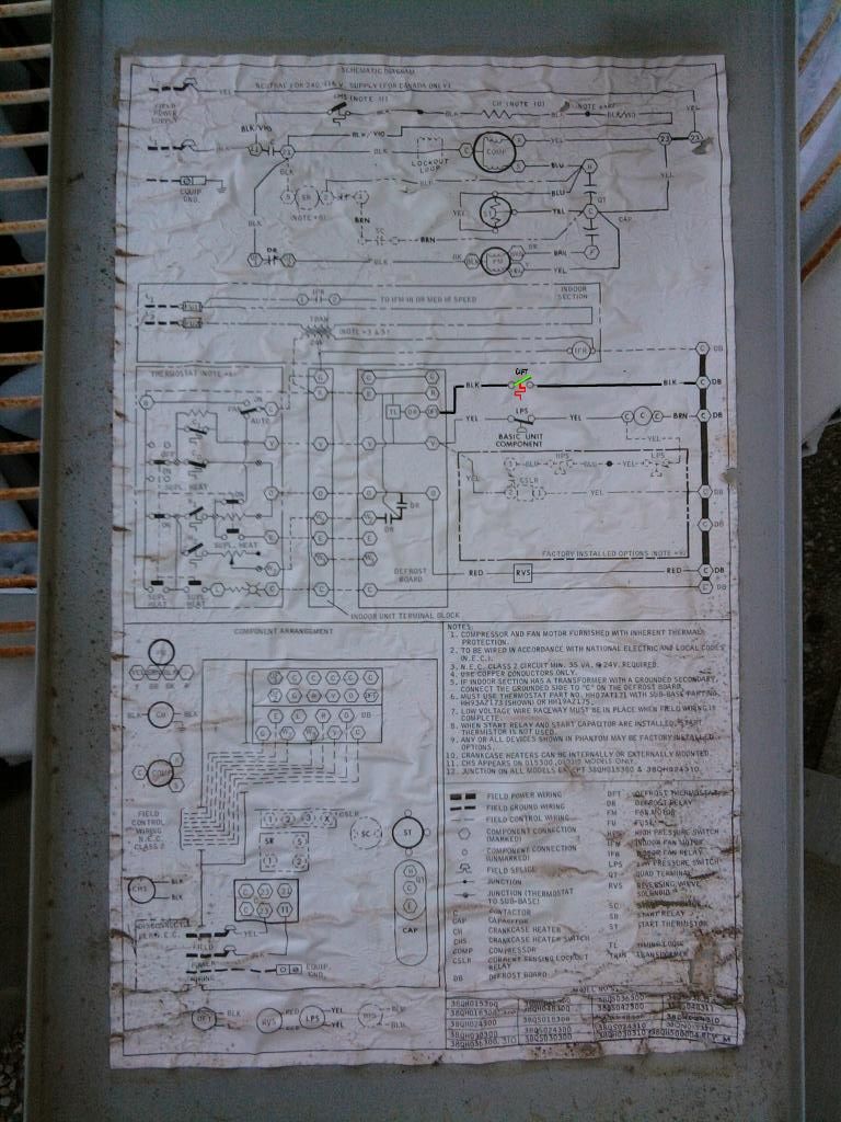

I also need help with the outside unit. It freezes up. There is just one board. I only see two test pins on the board that say "speed up" underneath. The board was changed by a tech and it didn't fix the problem. Currently I have to run the system in cool to defrost the coil, then switch back to heat. It takes about a half hour for the coil to thaw.
Post the model number of this ~ 1984 heat pump so that we can view the manual.
Has it been 8 years since the defrost control was replaced?
You have a black wire on the top right terminal of your 2004 defrost control that is connected to a terminal labeled DFT.
Looks like the DFT closes to common when temperature falls below it's setpoint.
Is this normally open defrost thermostat securely clamped to the coil?
You can ohm it when it is submerged in ice to see if it closes on temperature fall.

It has been two years since the board was replaced, I think.
If it is defrost t-stat is the one in the lower center of the second picture, it is tight.
So if you look at this picture you can see the DFT with a skinny black wire.
If I look at sensors in the unit (second picture), I see one with two skinny black wires (the one in the lower center of the second picture).
If you look at the first picture again there is only two skinny black wires. One on the DFT and one to the left of the DFT on C. If I probe the two skinny wires there is continuity. 25 ohm. Do I need to take he grate off unstrap the sensor and drop it in a glass of ice water?

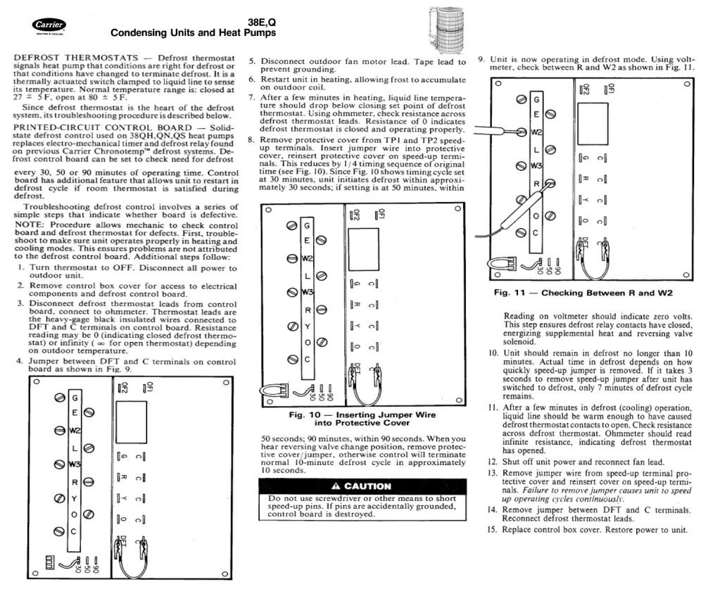

Will it go into defrost if you jumper the 2 terminals that went to the DFT?
http://www.docs.hvacpartners.com/idc.../38e,q-1sm.pdf
Your manual might help...
You will definitely hear when it goes into defrost. It will hiss as the reversing valve is energized and the large copper hot gas pipe to the house becomes the cold suction pipe with 1/3 the pressure.
If you read 25 ohms across your DFT when it is closed and you measure 0 Ohms when you touch your test leads together (to prove that it isn't just your meter or leads causing this high reading) I am leaning toward a new DFT requirement.
Join Date: Jan 2013
Posts: 19
Received 0 Upvotes
Thanks for the manual. I have gotten part of the way through the steps. It says disconnect the fan. I unplugged the brown wire (picture) from the cap and taped it off. Does this look/sound right? I'm not 100% sure it sounds like it should. With heat on the fan isn't running and i guess it sounds like the compressor is running. I measure 24 volts at W2 and R.
Is it safe to run it like this for minutes?
I jumper-ed TP1 and TP2 but I don't think anything happened, just a lot of creaking sounds. It still measures 24v at W2 and R.
The pipe the t-stat is on reads 24 deg with a laser thermometer.
I am worried I about running it too long without the fan. Should I be? Did I unplug the right wire to disable the fan properly?
That's not the right wire. It should be the black wire to the fan that is on the defrost control.
It is plugged into the black, plastic, square relay.

You don't have to disconnect the outdoor fan unless you want to make ice. You already have ice so I would leave it wired in.
Disconnect the DFT from common and the DFT terminal and jumper across the two terminals. Place a jumper across the speed up pins and restore power. Give it a heating demand and the heat pump should go into defrost in less than 8 minutes.
Remove the speed up jumper as soon as it enters defrost.
If it never enters defrost you need a new defrost control.

I defrosted the coil and checked resistance de-iced 1.1 ohm, 33 f on the pipe by the t-stat and 31 f on the t-stat with laser thermometer.
I read in the manual that the defrost should start within 30 seconds (troubleshooting step 8 towards the end). So I only waited a little longer then that.
I think that is a typo because prior to that in step 8 it is explained that jumpering the speed-up reduces my original time of 30 by 1/4. So I see where your 8 minutes comes from.
The air handler fan should be off during the defrost (cooling cycle) right? To prevent the inside temp from dropping during the reversal?
I did the DFT jumper from your last post, turned on heat, placed speed-up jumper and started a stopwatch. I waited 15 minutes and didn't hear anything.
#23
I guess I have to make ice again and start over.
If you have 1.1 ohms you don't even need to bypass the DFT.
Can I break it by not running the fan along time?
#24
Join Date: Jan 2013
Posts: 19
Received 0 Upvotes
If when it is in the defrost cycle (reversed/cooling) during a heating demand, wouldn't it cool the house with the air handler fan on? Or are you saying that it uses aux heat to offset (by mixing cold and hot) to counter the cooling effect of defrost cycling? I guess I am assuming that cold refrigerant is flowing through the coil in the air stream in the air handler. Or is the coil bypassed via a valve during a defrost cycle?
#25
You need a new defrost control.

Turn off the breaker(s) for the indoor unit and the breaker for the outdoor unit before replacing that defrost control.
70 bucks is a cheap fix. I would charge $99 to ring your doorbell on a service call.
