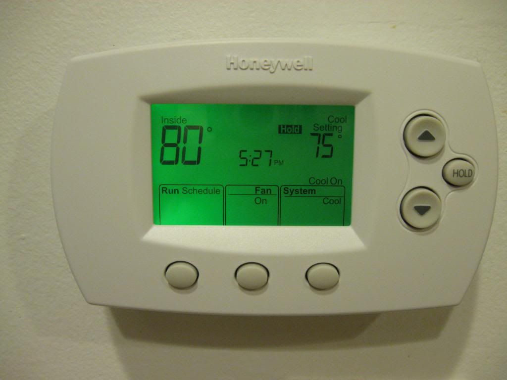

Does "Cool On" appear on the screen when the a/c is on?
I would suggest you run all of the tests. When you run these tests you will have to verify that the fan is running, the condenser is running or whatever is indicated should be happening.

"Cool on" does appear on the screen, and about two seconds after I turn on the A/C, the fan comes on.

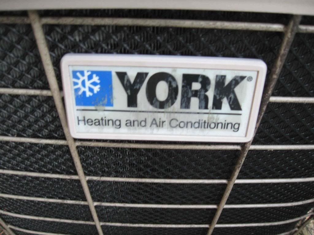

Thanks again for the assistance. I've changed item 6 to equal 3, and hope one of the pics will answer whether or not the compressor has 2 stages. I usually replace the filter but never bother to clean the outside unit unless there are leaves or snow blocking it. I will do as you say and clean it as well.
I will attempt to upload links to pics of the labels on both outdoor and indoor units in case there's info. that's useful for the programming.

Based on your photo of the original thermostat wiring I believe you should have the white wire going to the Aux terminal and the black wire going to the E terminal on the new thermostat. The brown wire I am not sure about. On Trane heat pumps it is taped off and not used with programmable thermostats but on your unit I have no idea. You mentioned in your first post that you thought it was a 1.5 ton unit. Based on the model number HP036X102A it is a 3-ton unit. Here is a link that will have a lot of valuable info for you: http://www.upgnet.com/PdfFileRedirec...ETG-A-0106.pdf
