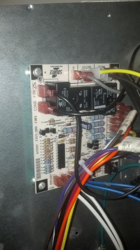

Okay, both pressure switches are located inside the unit, rather than taking it apart, i traced the wiring back to the circuit board. Each of the two pressure switch terminals on the board are reading 27.84 VAC when connected across the C terminal.

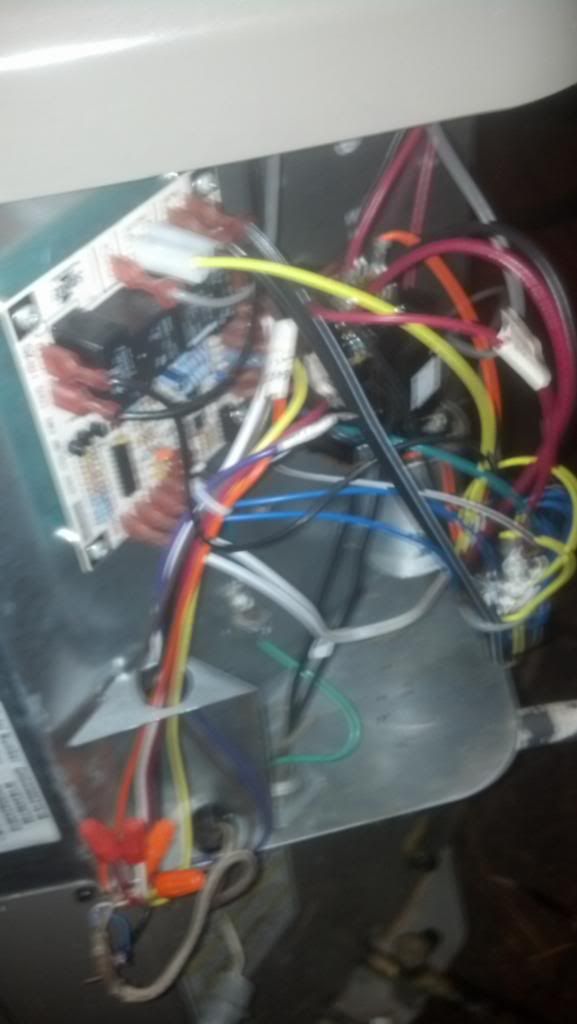

I went ahead and cut the zip-tie holding most of the wires together so I could better trace whats coming from and going to different places. One end of each pressure switch runs into a connector linking them together, the other two ends run to the circuit board shown. I am testing 27.84 VAC at both links on the circuit board as well as 28.04 VAC at the link between the two switches

The stat wire runs to the air handler and the heat pump wire runs to the air handler. Can you post the wire connects at the air handler?
A pic of the wiring diagram for your outdoor unit would also help since I cannot find a useful manual for that unit.

Did you have any luck with this issue? I have been experiencing the same exact symptoms for several weeks now. I had a repair man tell me the defrost board was bad, but i just swapped it out and i'm still having the same problem.

No, still haven't figured out what the exact problem is.
Stat - Thermostat
A.H. - Air Handler
H.P. - Heat Pump
Stat Green -> A.H. Green
Stat Brown -> H.P. Green
Stat Red -> A.H. Red -> H.P. Red
Stat Yellow -> H.P. Yellow
Stat White -> A.H. White -> A.H. Brown -> H.P. White
Stat Blue -> A.H. Blue -> H.P. Blue
Which explains why the green is connected to the O on the outside unit, but is that correct having the white connect to both white and brown on the air handler? The air handler does not have a yellow connection, which makes sense.
I'm not sure what you are looking for beyond the picture I posted previously. I cannot find any better wiring diagrams for the unit in any of the manuals, so other than trying to draw up something on my own, I don't know that I could provide anything better than the picture given.

Based on your picture, it looks like we have different units, but our defrost control boards are identical. Here is the schematic that came with the new one i just installed.
