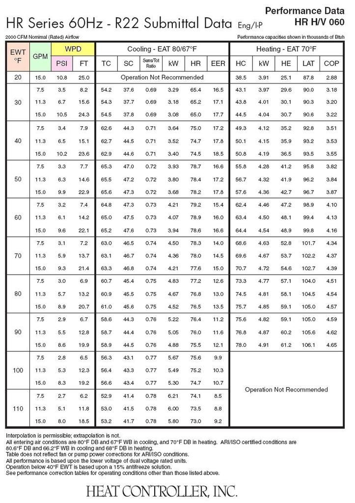

Comfort Aire HRV060A1C00ART.
No location listed.
I don't see any heating sequencers to get stuck on. Electric heat is controlled directly from the logic board. Easy enough to disconnect but shouldn't have to. Found an excellent manual on that unit. Actually quite a rarity.
HR_series.php?file_id=20825

Yes the drain connections sound correct but I have a few questions.
How do you know that you are moving 7 GPM?
Do you have Pete’s plugs at the unit?
Do you have a digitalmeat thermometer?
Most vertical units use a hose to make an internal P-trap. Did you omit the trap when you repiped this drain?
I have a water flow meter on the geothermal unit on the side of it. It was marked at the 9GPM range, but when I had Idaho Geothermal come out. he told me i could lower it to 7.5 gallons to save a little water.I also have 2 thermometers for in/and out
Temperatures are 55 degrees in and 33 degrees out. It does not have a P trap. It is a flex tubing then connected to PVC that goes into my drain. It's exactly how it was set up. Expect when they glued the PVC together, it was uphill and not downhill. So gravity couldn't take the water out. It drained the 2 gallons I put in the pan immediately.
Should I make it flow a little more than 7.5 gallons? I just turned off the 2 breakers for my heat strips and I'm seeing what the KWH usage is for a 24/hr period.
I have no idea what a petes plug is, or where it would be. Just request a picture of any set up and i'll definitely show you a picture of it.
With a 22 degree water delta tee I would say that you are not moving any water. I suspect that you are reading a pressure gauge instead of a gpm gauge or your gpm gauge is broken.
I would increase the water valve until the delta tee is 10 degrees to 7 degrees.

A 7 degree water delta tee at 7.5 GPM is 26,250 BTU heat of extraction.
It should be 41,200 with your water temperature and gpm according to your manual.
You have a 60,000 BTU unit.
Do you see any oil streaks on the evaporator coil?
I’d say that you probably have a refrigerant leak.
What is the return and supply air temperature?
Bet the air delta tee is poor.

I am impressed with all of the gauges that you have installed. I never see GPM gauges and thermometers installed on geothermal equipment and I have been working on geo for over half of my life.
Those 2 pete’s plugs and my water pressure gauge will give me the pressure drop. That chart will give me the gpm output at the current pressure drop. The pete’s Plugs allow me to get delta tee for the btu output calculation.
The btu output, voltage and amperage allow me to calculate the efficiency.

We have 34,875 BTU Heat of Extraction.
Take a look at the HE column for your 5 ton unit at 50°F entering water temperature, 41,200 BTU.
Look at the difference with 60° water 47,200BTU.
You are still a little short of specs.
We probably want to see around 45,000 BTU HE with 57° water.
The COP should be around 3.9 but I bet if you had a Uni-T UT210E meter or a similar clamp meter to get voltage and amperage your efficiency would be lower.
I still suspect that we are low on refrigerant.
