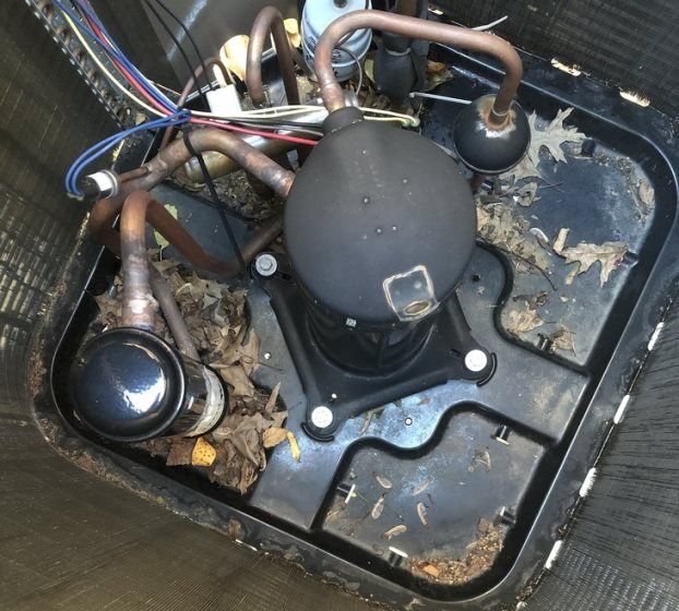

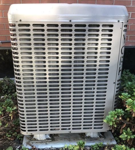

I also have this unit outside which I believe is a heat pump (there is also a second one I believe to be just A/C). When the 2nd floor thermostat starts heating, the heat pump's fan starts.
Does the handler have burners in it?
Does it seem like more of the handler issue or the heat pump?

Thanks for the pictures. That is a heat pump air handler. Heat is created from the outside condenser as well electric coils inside the air handler. The installer is supposed to check off what heating kit that has in it..... they didn't.
I still need to know what amperage that big breaker is.
At this time of year..... the heat pump should be able to heat with no problem. When it gets real cold and can't maintain heat.... the electric coils will come on. It's better to leave the thermostat set to one setting. It's more cost effective to have the heat pump make the heat than the electric coils. The heat pump is slow heating. The air it puts out is warm..... not hot like from a gas furnace. A heat pump must run for a long time to create the needed heat.
