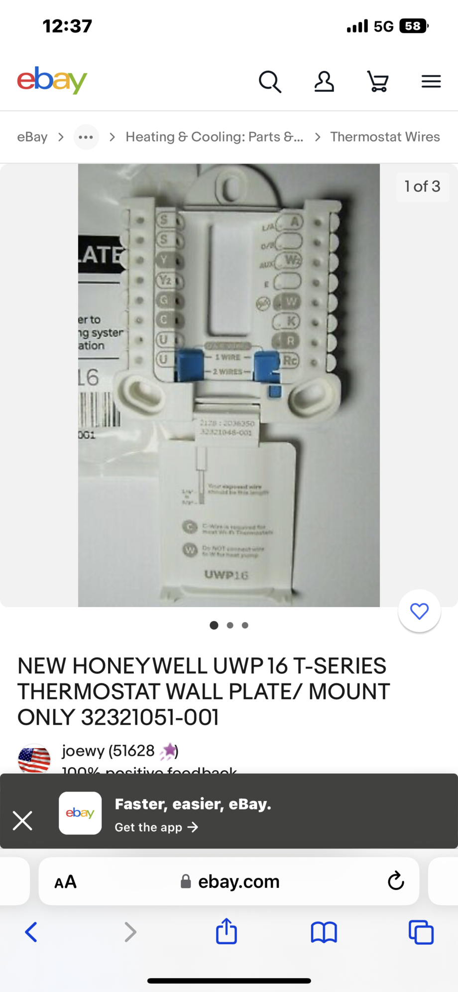

New t5 Honeywell thermostat connections minus the U connections
Current thermostat connections
Will the t5 Honeywell thermostat work on my unit ?

Welcome to the forums.
Almost any stat will work here. The T5 will too.
It appears you have a heat pump with back up electric strips. That means you use the heat pump labeling which also means that pink jumper is in the wrong place and doing nothing.
R ---------------> red --------------> R (keep slider in one R position)
Y ---------------> yellow ----------> Y
C ---------------> blue -------------> C
O/B ------------> orange ---------> O/B
G ----------------> green ---------> G
AUX ------------> white ----------> AUX/W2
Program the new stat for heat pump operation with back up heat/aux heat.

Wonder what that pink wire that they cut the jumper from goes to ?
Old 01-16-23, 03:04 PM
PJmax's Avatar
Join Date: Oct 2012
Location: Jersey
Posts: 71,620
Received 3,322 Likes on 2,983 Posts
That pink jumper should have gone from AUX to E..... looking at the correct labeling below the terminals. This jumper would have allowed just the electric heat to run when in E (emergency) mode.
They just used the piece of pink wire as a jumper.
The wire that was cut off from the cable is a pink spare wire.
L is light.... as in warning or trouble light.
