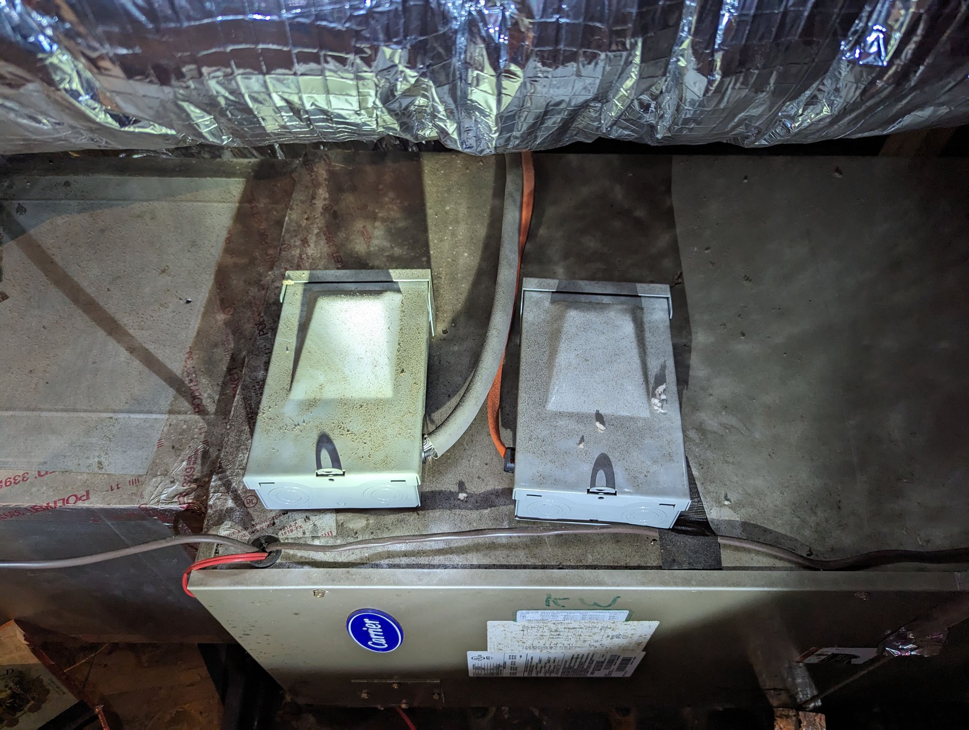

What circuit breakers/switchs/fuses do I throw before changing a thermostat?
On Thursday, I attempted to change the thermostats for my first-floor conventational HVAC system and second-floor heat pump HVAC system.
Each time, I threw:
A 15A CB labelled Gas Furnace,
2 25A paired CBs labelled Up Heat,
2 25A paired CBs labelled AC,
2 30A paired CBs labelled AC, and
2 60A paired CBs labelled Up Heat.
Thinking I had cut-off all of the power to both systems, I attemped to change the thermostats without success. Both times, after putting the faceplate on, the display did not lightup after waiting 5-7 minutes.
On Friday, the owner of an HVAC repair and installation company that he started 20+ years ago said I burned a fuse in each of the units. He blocked my line of sight so I could not see which fuses he replaced. However, after he left, I was able to determine which fuse in each unit was replaced by the absense of any dirt or dust on each.
I am a fairly successful DIYer and I must have missed something that should have been obvious to me, but wasn't.
Do I throw the same circuit breakers and the replaced fuse until I am done?
Do I pull the two pull-fuses on top of the air handling unit in the attic and the one outside for compressor?
Are there any other switches or fuses that should be thrown?
Should I just through the 200A whole-house circuit breaker?
Yup! I have these two sitting on top of my air handling unit... I am surprised that throwing all of the circuit breakers listed in my previous post did not deenergize those two boxes on the air handling unit. Why should I not be surprised by this? Thanks!
I see two heavy cables.... one into each disconnect.
I see a thermostat cable, a condenser cable and a float wire.
I don't see any other cables which means the box with the orange cable should be the disconnect.
I see the large cable getting pulled out of the disconnect. That should be corrected.
