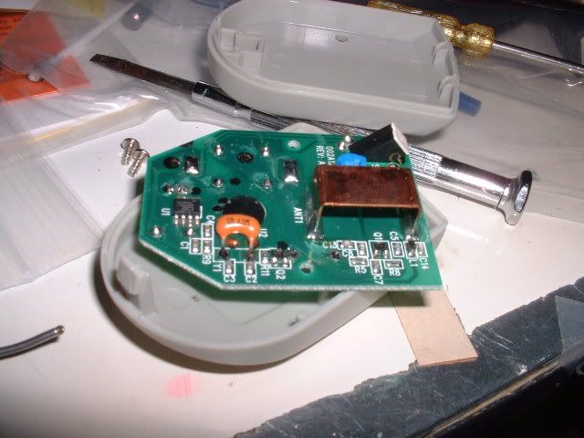

XRing's Avatar
Join Date: Mar 2008
Location: Greater Boston
Posts: 103
I just couldn't help myself!!
I've got the DIY sickness!!
The receiver in the den when into it's red & green 'lost signal' mode the other day for a few minutes.
Then it did it again yesterday! The other receiver is not so far from the garage and it wasn't effected. (Stayed green).
I blamed shielding effect. The path loss was too great for the 'connected' signal that occurs every 20 minutes.
So, I remembered the guy I read about who added a 1/2 wave antenna to his transmitter and I decided to add a 1/4 wave (7.2") antenna to my two transmitters. (There goes the warranty)!
That wide copper strap is the antenna. I attached the 7.2" wire at the center of this side of the loop. A small hole in the case for the wire and I was done.
So far, it's working fine..
