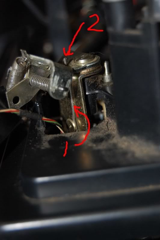

So, I've inherited my dad's record player and am/fm/8 track player, and I've got it working to the point where I can play a record and have it come out nicely on speakers. The only problem is that the arm only moves in so far before it hits a bit of resistance from a spring internally and refuses to move any closer than (approximately) 1.5'' from the center.
This is a problem, because my records now won't play the last little bit, and it just skips over and over. If I put pressure down with my finger (slightly), I can work it through, but if I take my finger off, it just moves out to the skipping point again.
My record player has no counterweight, and it looks like what I'm going to have to do is open it up and attempt to move what's giving my record player arm resistance. Anyone have any experience with this kind of thing?
Pictures to come if they're requested.

Wow, a serious museum piece. There really should be nothing preventing the tonearm from moving all the way to the center. My guess would be there is debris of some kind that is obstructing the free movement. Time to get inside and have a look.
BTW, the pics show it in the 78 rpm position; is that just coincidence or are you actually playing 78's?

There is a possibility that the tower that supports the tonearm has twisted away from the center of the turntable.
See if the mount that supports the tonearm will move.

My aging memory tells me that there was some kind of limiting screw adjustment under the tone arm where it mounts to the table. It had something to do with the changer trigger. Backing it out too much caused the tone arm to skip across the label and bounce off the changer post.

There IS a type of screw there; I don't think it fixes my problem, however. I've tried tightening and loosening it, but it hasn't done anything so far.

The problem is the wire (1) poking through the top (2), which is providing the resistance. I guess I'm going to have to remove it in order to fix it.

That wire should be routed up into the arm, away from the mechanism. It looks like someone took it apart at one time and accidentally pulled the wires down. There's probably some slack in the wires under the table.
