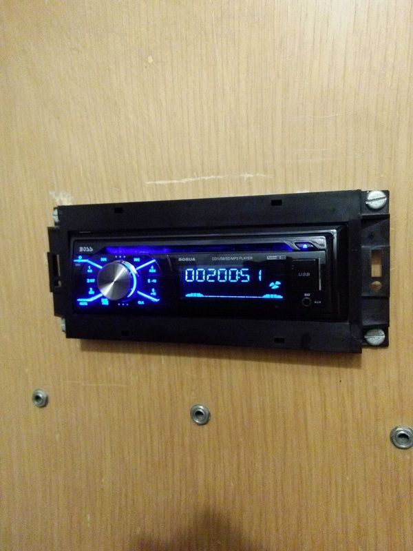

OK you may remember this stereo
http://www.doityourself.com/forum/ho...tml?highlight=
How hard would it be to add a car CD player to it. I would have to cut a hole into the wood on the side to slide it in. I supposed the hard part would be finding out which wires are power and which are the left and right speakers. Since they operate on 12 volts I would need a universal power adapter which a voltage selector.

That sound gear has RCA aux in jacks for connecting outboard equipment. I don't know how many things you can switch between. You may have to unplug the cassette and connect the CD player. No big deal.
A car CD player usually has speaker lines out and would have to be converted to RCA. Do you have a particular make and model picked out ?
Any 12v at 2A or so power supply will work.

If it's an indash unit...... most of them have RCA output jacks.

Both of those choices would work well together.
That Pioneer unit has a pair of RCA jacks for audio output that you can connect directly to your music system.

I currently have a 5 disk CD changer hooked up to it but I want a CD player bult into it. I got the player but got a wiring question. I got a yellow wire that says battery + and has a 15 amp inline fuse and I also have a red wire with a 0.5 amp inline fuse that reads acc +. Which one goes to the positive on the power supply or do they both go on it? What does acc stand for?

Yellow is the main power and holds the memory.
Red is accessory wire and would be live when the key was turned on.
You'll need to connect them both together.

So far so good. Not installed yet but did hook it up to the power supply and tested the RCA outputs and so far it works.

It is complete and working OK so far. I used piggyback cables so I wouldnt have to remove anything. It is mounted using the metal jacket sleeve they come with and a aftermarket adapter for car dashes.The cassette player has since been replaced with a Pyle pro duel cassette rack mount system.

Looks good in there. Nice job.
