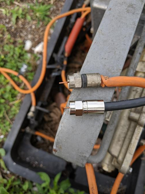

I then looked at the lines outside, making sure nothing was nicked by a lawn mower, all looks good until I traced it to a green box in the back alley. In that green box there is only ONE cable connected (guess I am the only one haven't cut the cord) and there are like 5-6 other cables disconnected.
Upon close examination, the single connected cable has been pinched badly. May be a car bumped into it or whatever.
In order to make sure this is the cable feeding my home, I disconnected it and my TV and internet service was interrupted.
Next, I twisted and bent the cable where it pinched in the opposite direction and it seems to intermittently made things better. But a few hours later it went bad again.
I am reasonably sure this is the real issue here. So I called Comcast and said hey I think I identified the issue can you send someone out to remake the connection, I don't need to be home and you can come whenever. They said no, I have to be home, and they have to schedule it. I told them they already missed two appointments and I actually took time off work to wait for them only to be no showed. They wouldn't fix the cable unless I schedule a tech appointment and wait at home.
So my question is, I think this orange color cable is just a regular coaxial cable may be RG59, RG6 right? I haven't worked with these outdoor buried cables but I do have the tools to strip and crimp regular inside coaxial connectors. I know this is Comcast's equipment and technically I am not supposed to do anything to it but I am sick of waiting for them and it should only take me 3 minutes to fix this myself. Is there any reason I cannot just cut this off behind the pinched cable, strip and crimp it with a regular RG6 connector myself?

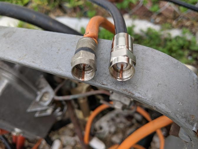

OK here are some additional pictures of a RG6 cable I have next to the orange comcast cable. They look similar in diameter and the copper conductor looks the same (to me).
On the existing connector at the end of the orange cable, there is a label on it saying "PPC EX6".
Does this confirm it is a RG6?

That is RG-6 then..................

Are there different kinds of RG6 connectors?
I used a standard coax stripper to strip the orange cable. It seems to strip fine and I folded back the braided shield, there is some gel like coating smeared on it which I assume is for the exterior weather proofing.
Then I tried to use a standard RG6 F compression connector on it. The foam core (which is inside a thin layer of aluminum foil) will not insert into the smaller hole of the connector. I thought may be I didn't strip it right and strip it again at a lower portion of the cable, same result. I was able to compress the connector onto the cable, but the foam core wouldn't push in all the way so right now I have an extra long copper conductor.
The service seems to be back to normal after a system refresh myself. Hope that will last. If I can figure out what I am not doing right I would like to remake that connection.

There is RG-6 and RG-6 quad shield. Each has its own connector.
The quad shield has a larger center core and four layers of shielding.

I work for Dish and have worked for Comcast before, your process is the right one, that connection is damaged and hopefully when you stripped the coax you didn't see anything with a "white powder" residue. If you do, that means that moisture has made its way into that coax and is travelling through the insulation and rotting that entire cable.
As far as the fitting goes, you're on the right path.
1.) Cut a fresh end off of the cable straight across.
2.) Put the cut end flush with the back edge of the strippers, and give a few turns until it feels "loose"
3.) Pinch and pull the strippers off to remove the outer barriers.
4.) Fan out ALL of the metal fibers (but do not remove) and leave aluminum intact (the metal fibers in there are what the fitting actually clamps onto and some systems use as a ground as well)
5.) Use a fresh fitting and center the white insulation with the middle.
6.) Push and twist the fitting into place--the white insulation should be flush with the inner bevel (don't go further)
7.) Compress and cut off any excess copper wire from outside of the fitting.
