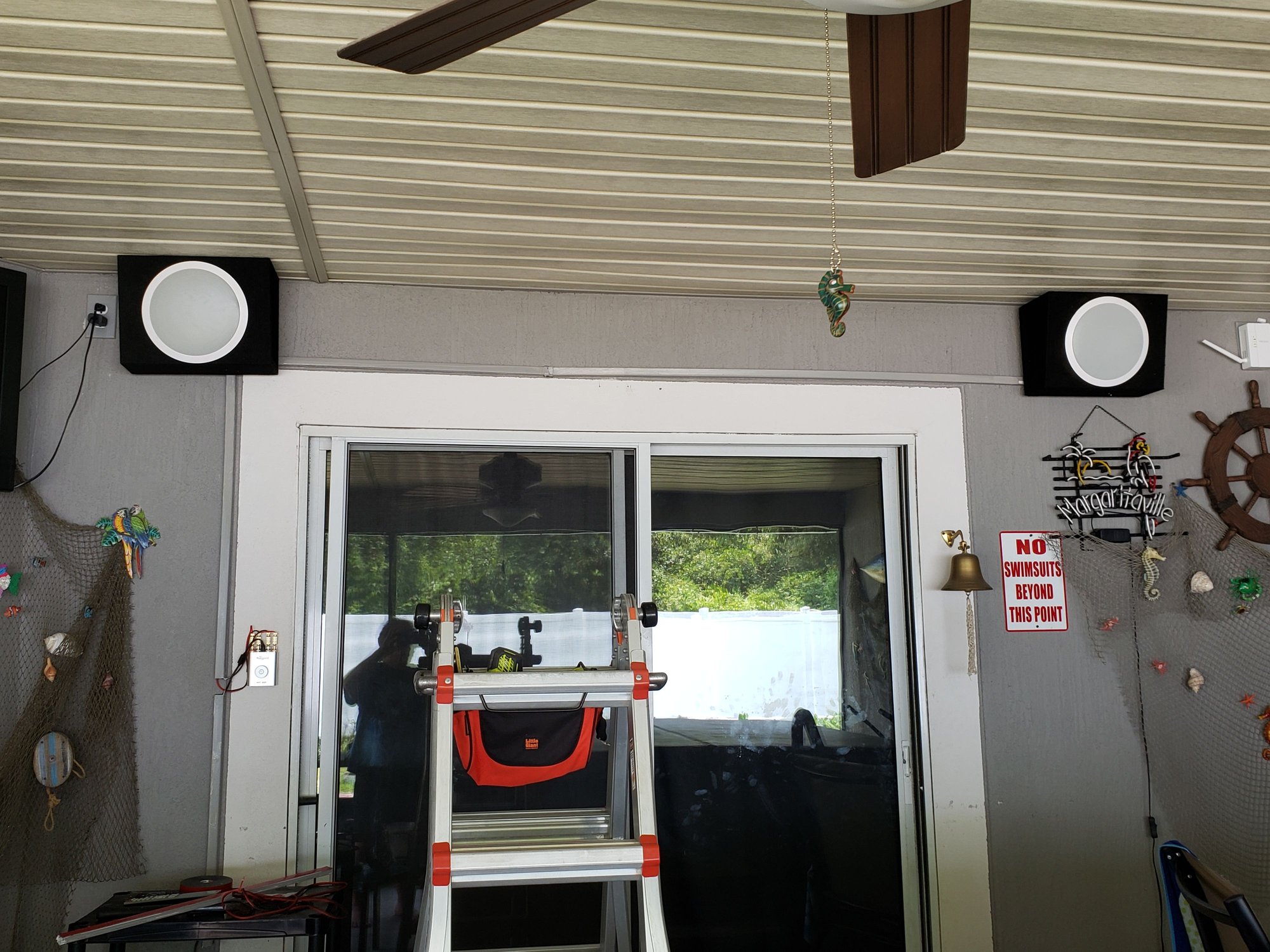

It wouldn't use your old speakers but I put a setup out on my patio using 2 bluetooth amps, 4 8 inch speakers mounted in truck speaker boxes. I hung the speakers using TV mounts and ran the wires tucked behind the soffit along the ceiling. I am not very handy so I did not want to mangle the soffit trying to mount them there. I used cheap nobsound bluetooth amps and micca 8 inch speakers from amazon. They sound great for about $40 each. Pyle makes a few 4 channel bluetooth amps but you would still have to run wires.

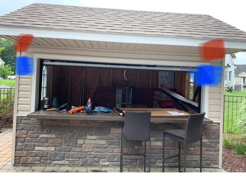

Are the Bluetooth amps connected to a receiver or just powered by an outlet? Ideally I would like to plug in a set of speakers and connect via Bluetooth or WiFi. I would like to attach outdoor speakers under the eve on both sides of the bar window high up so big box speakers won’t work and won’t look good.
The red marks are where I want to mount speakers and the blue marks are where I want to mount a pair of small light fixtures.

Since I started with just 1 I connect a firetv to one amp via Bluetooth and it is wired to the input of the second amp. I can also connect my phone. With firetv I can play siriusxm, prime video, YouTube, pandora or stream stuff from my plex box. I have a bunch of concert videos.

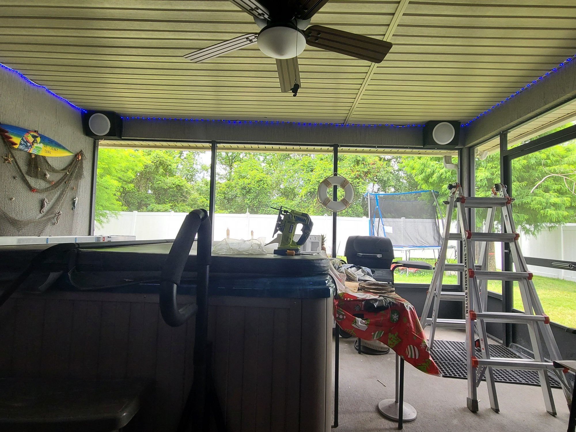

I'm old school with audio - I like to have true stereo separation. That's why I have a wired setup, a Bluetooth receiver out side connected to a conventional stereo inside. From there connections to (now old) 2 outdoor RCA speakers, left and right channels. They're also connected to a volume control, not so necessary these days since the source is usually a phone, pc or tablet with volume controls. I heard Sonos speakers in a commercial building - the quality was great, but each I believe was a mono summation of what was broadcast via Bluetooth
Many music listeners are fine with a Bluetooth speaker - but many that I've seen are not true stereo, even if they were they won't provide the true stereo experience.

I went with that cheap amp at first and added the second because the 4 channel pyle amps had people complaining that they were not stereo and I already tried the one. They both have an aux input. I use the aux out from one to feed the signal to the other. I have not bothered plugging anything in to the input of the main one. I may add an echo input so it will work with alexa play 'everywhere'.
