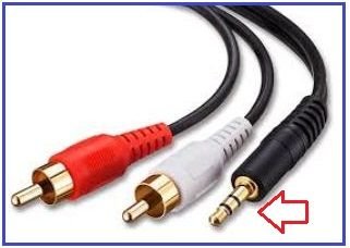

The green audio input jack is going to be a stereo jack. You need to make sure your connecting cable has the stereo 3.5mm plug on it. If it's a mono plug...... only one speaker will work.

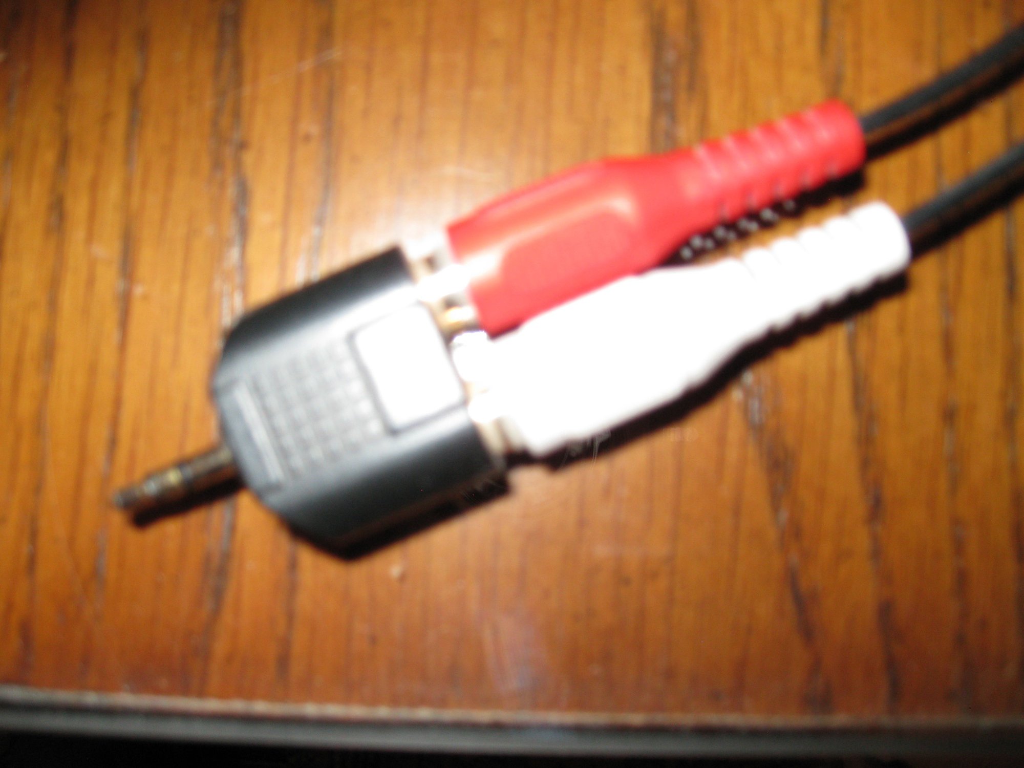

Here is the adapter I have always plugged into the green audio input jack. It has the two black stripes on the metal pin. This is correct.............right? So what is the problem? Is there an internal defect with the DVD player?

Since you plug in another stereo source and it works..... it would appear to be a defective RCA to 3.5mm adapter.
The left channel is the tip so pulling the adapter out probably won't make the left speaker work even if the adapter is bad.
I didn't think those adapters failed. I don't see any visual defect. So you're suggesting try a new adapter
only for now, and not a new red/white audio cable yet?

I'm applying logic.
You swapped the RCA cable ends..... left and right. The left channel remained dead.
If it was the cable or the player.... the dead channel would move.
You use a different stereo source and both speakers work
What else is left ? The adapter.
I don't use those adapter blocks I use the cord as shown in my previous post #2.
Ok. I understand what you're saying. So I'll go to Walmart this weekend and pick up the RCA audio cable with red and white connectors on one end, and the 3.5mm double striped stereo black connector at the other end. And I'll avoid the adapter block this time. I'll report back.
Another test you can do, using a multimeter set to ohms or continuity or resistance.
On adapter, measure from plug tip to hole in white jack Should get full continuity or -near 0 ohms.
Measure from plug middle strip to hole in red jack. Should get full continuity or near 0 ohms.
Measure from plug long stripe (closest to adapter body) to either jack shell in back (two tests). Should get full continuity or near 0 ohms each time.

Success! I replaced the 3.5mm to RCA audio cable today and I now have sound from both speakers.
Now that I look back on it, I can remember accidentally knocking over the right speaker a couple times some years ago. The speaker took a 2 foot plunge to the floor dragging the adapter speaker input connection with it. I'll bet this damaged the cable end plug or the adapter. Thanks guys.
