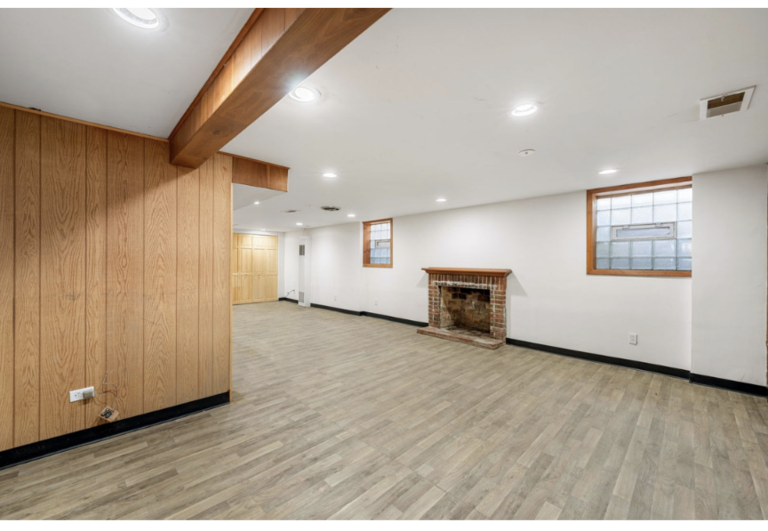

From the way that the opening seems to have a beam over it, coupled with the fact that where the support would be for the end of that beam has a wall underneath it in the basement, I would assume it to be a load bearing wall. It's possible it's not - but a 20' span for the living room ceiling would be unlikely.
So I'd go into it planning it to be load bearing. If you can keep a column down the middle (where the existing wall starts), it would be easy to open up. Just add another beam another 10-12;
If you want to expand it to the full 18' span, it would need to be probably a 3x9 LVL (from some quick googling). So it wouldn't take up much more (if any) height of the ceiling. If it were to be pocketed into the ceiling, it would take more work, but would open up the ceiling to hide the support beam. Definitely doable, but wouldn't be all that cheap between the beam installation, support columns, and support down into the basement and likely a new footer for the column. Plus the finish work including the flooring which will take some effort to match.

Looks like a load bearing wall to me.
Are there columns in the basement ?
If yes...are they on that blue line ?

I can see a beam in the basement that sort of aligns with the basement wall.
