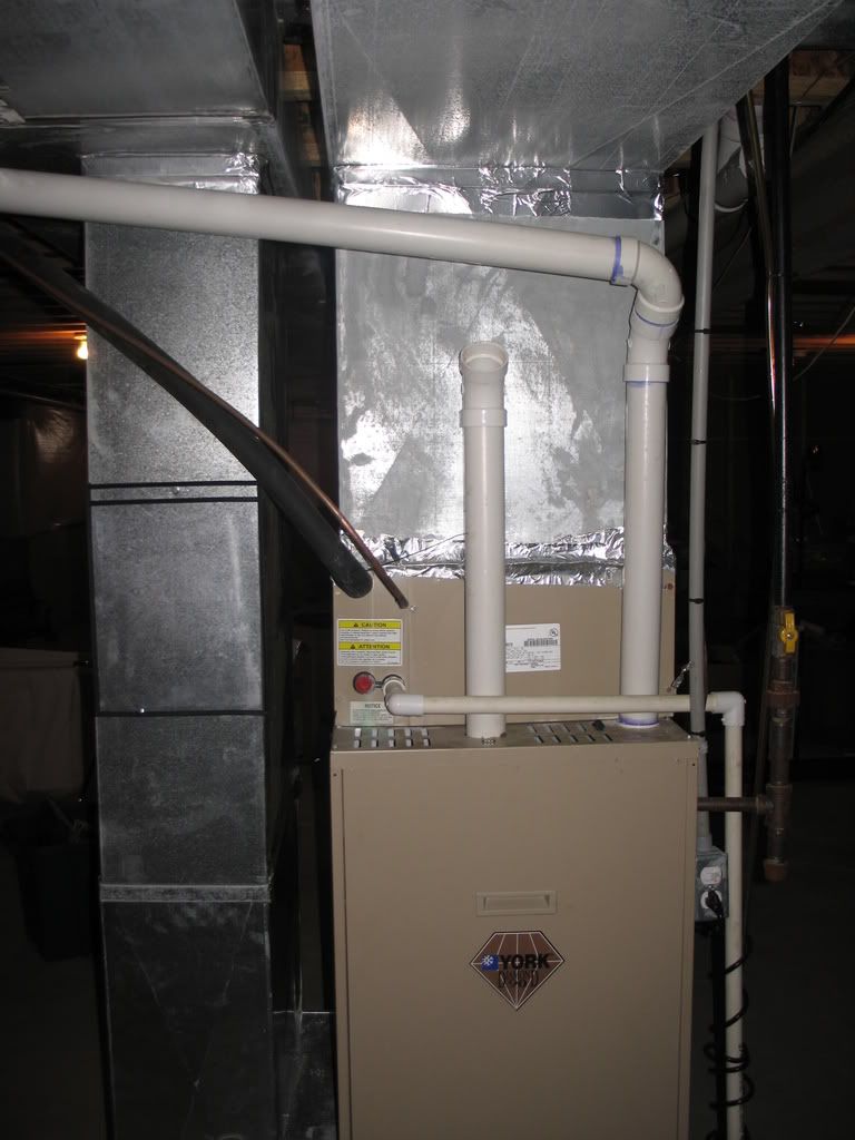

I purchased the Honeywell HE260A humidifier and install kit. Before I install I would like advice for best location to install the Humidifier, Bypass, and Humidistat. I would also like to hardwire the electric source using the transfomer that came with the Honeywell and have it run on call of heat. can this be done and if yes, How?
My furnace is a York Diamond 90 mdl # GIUA0485218. I have included front and back photo's of the furnace and inside.
My concern is that I don't have much space on the supply side and don't think its a good Idea to cut near the cooling / heat pump coils.
Thanks for your much needed help on this.

YOu got plenty of room on the back side of the unit to mount it.
Look down at the control board in the blower to see if you have ACC, HUM, or EAC on it.
It's an older model, so I am not able to pull up any manual on this.
If you not sure what you are looking for, take a photo of the wire diagram that should be on the back side of the blower door.

Thanks for the diagram, Look for two HUM. That is where you can wire the transformer to.
From what I can tell on the photo, looks like you may have a "Slab" type coil.. Not an A style. I could be wrong.. Just cut a small hole to take a peek in to see what behind there.. If it turns out to be a slab type, then I would go about 6" up.

I never used the kit, and A few people who came on here didn't either.
I always try to mount the humidifier itself on the return, and bypass on the supply, It gives me the comfort of knowing if there is any water issues, you are not going to get water into the furnace.
You can buy the stuff by itself.
-6" Metal duct.
-6" Starter collar.
-6" Damper (To close in the summer/Open in Winter)
-1/2" Vinyl Tubing.
-Copper Ice Maker Kit.
-12/2 t-stat wire.
