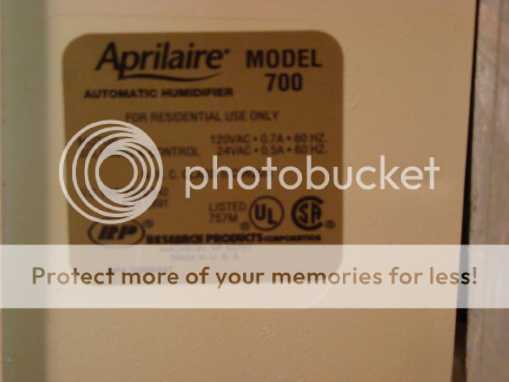

I have a Rheem furnace would like to connect my Aprilaire 700 humidifier with automatic humidifier control, to.
I have checked and the connections on the left of the furnace circuit box, they are 24V, which are hot all the time.
The connections are labeled as: Y, G, W, R, C

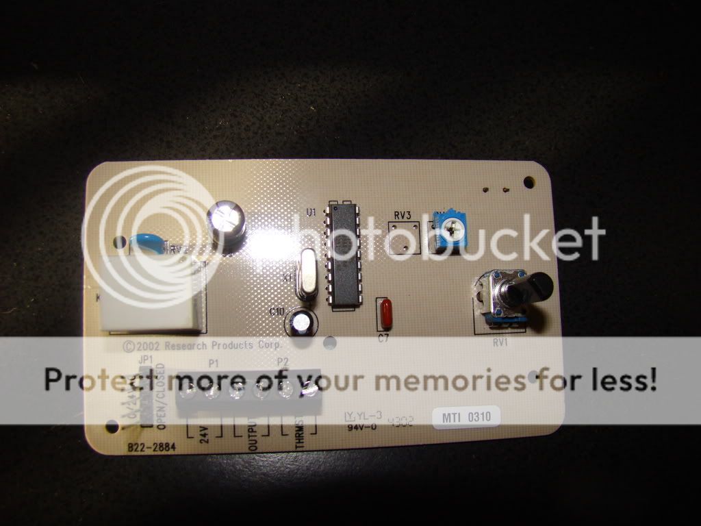

One problem I am having is, the automatic control I have does not match the diagram I received. The control has 6 connections, two labeled – 24V, two labeled – A/A, and the last two are for the outside temperature sensor, which I have figured out.
Have no idea what the A/A connections are for.

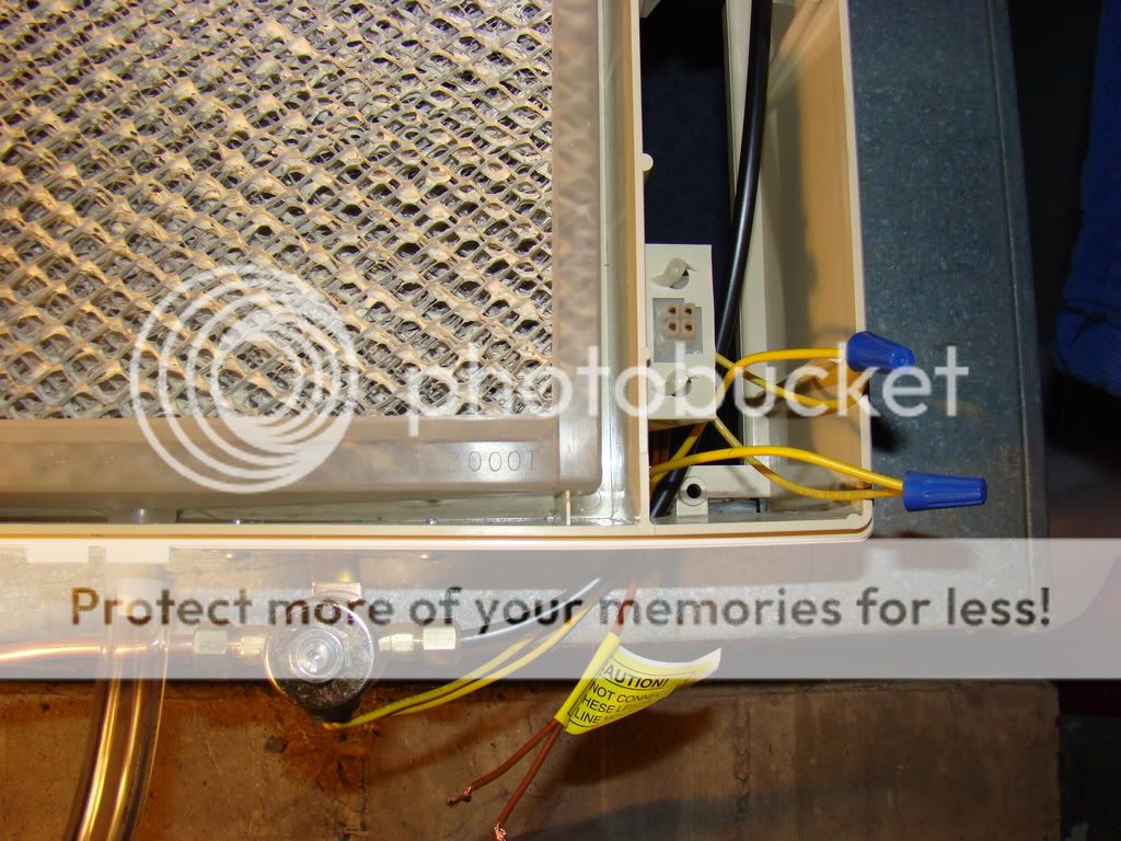

The Aprilaire 700 system has the solenoid attached to the same 110V that the fan is.
Then there are the two brown wires where are also attached to the plug as the solenoid.
The furnace is a Rheem model# RGED-06EMAES

That's an old humidistat.. Are you reusing this or was this already there?
I can't find the manual for this humidistat, R and C on the furnace will be your power, from there I am blind.
If you got the manual, scan or photo it for me to see.

Put it on OHM scale, and take a reading between the two "output" and see if that open and close as you change the dial.
If nothing, then try between Output, and one of 24v section.

I contacted AprilAire and they were able to email me a PDF of the correct manual. They called it the "old model" 56.
If you would like me to send it your way, just let me know.
Thanks again for you support.
Did all this work, didn't want it to go to waste.
With humidity control in Off or Test position, temperature sensor shorted and un-shorted, results did not change. Pins 1 thru 5 not shorted.
(Pins: 1-Bottom / 5-Top )
Pin 1 connects with 24v Left
Pin 2 is dead
Pin 3 connects with Output Left
Pin 4 connects with 24v Right
Pin 5 is dead
With Pins 1 & 2 shorted along with 4 & 5 shorted – No change with or without temperature shorted or humidity control in Off or Test position.
With Pins 1 & 2 shorted along with 3 & 4 shorted – 24v Right & Output Left connected.
No other connections found.
Hope this helps and doesn’t give too much information.

ok, Tie the 24 v to R and C on the furnace.
Then the Output to the two brown humidifier wires.
Old 02-20-09, 08:25 PM
Jay11J's Avatar
Join Date: Sep 2001
Location: Rochester, Minnesota
Posts: 18,427
My Bad.. I mean W and C.... NOT R and C.. My mind was thinking of the newer style t-stat.

Thanks for the update. I did try the R & C....it would run all the time. When I checked, the W & C would only have power when the furnace did.
