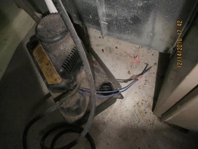

After a little more research, I think I definately want to get a pass through humidifier rather than the drum...
Now, as for the floor drain, I attached a pic of the pump I have below...Im not sure if this is sufficient for the drain on the humidifier or if I should replace the pump, or simply have 2 pumps...How much drainage is there from a humidifier?? I would rather upgrade my pump or have 2 pumps than come home to one that quit on me and have a mess on my hands...The current pump has a transformer that plugs into a dedicated outlet near the burner..
Regarding the humidifier itself, Im looking at the Aprilair 600...any thoughts or other recomendations??

Looks like your pump is used for the A/C. I don't see any low voltage wire going to it to kill the equipment if the pump fails.
That pump should be able to handle it just fine, but if this pump don't have a cut off wire, then a new one should be used.

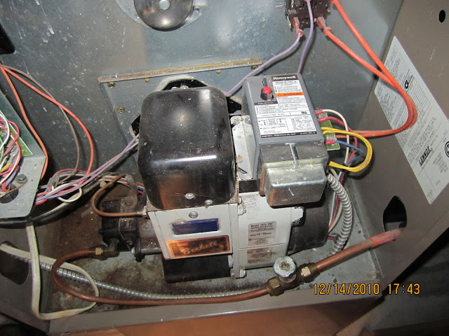

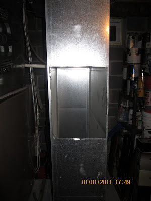

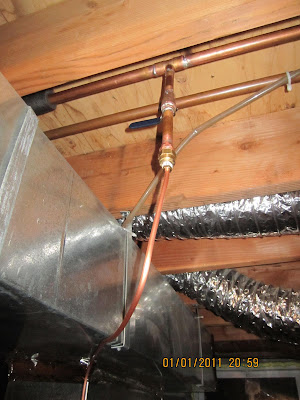

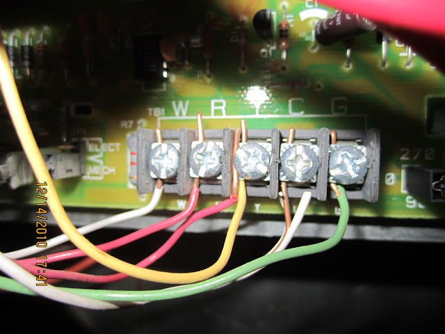

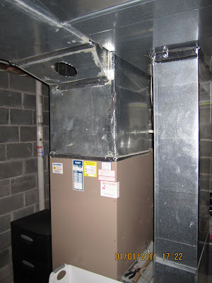

Ok, I got a chance to take a few more pictures...
You can see in #1 below the two wires from the pump that are not connected. I assume these are the low voltage wires you mentioned in your last post that need to be connected the the HVAC system so that it will shut down if the pump fails...
Photo 2 & 3 Show where the thermostat wiring is. I assume this is where the new humidifier will be wired to.
Photo #4 is additional wiring for the burner...I dont know what I have to connect here...

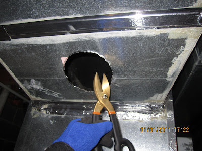

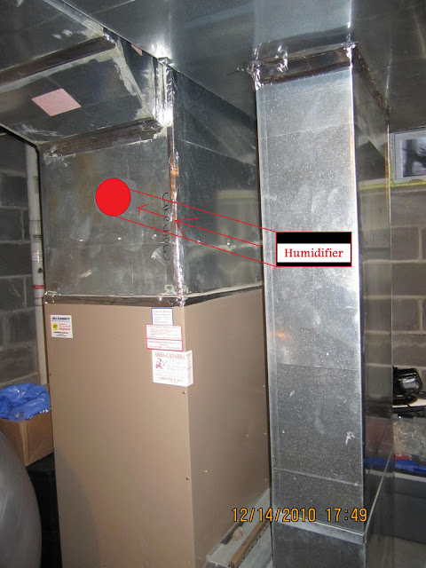

Photo # 5 shows where I intend on mounting the Humidifier on the return and routing it to the supply. The drain wire will go between the return and supply into a tee for the existing A/C drain into the pump.
I want to wire the humidifier so that it turns on only when the heat kicks on, not the fan. Im just not sure how to hook it up. Also, what is your recomendation on the pump I have?? Should I just get a new one to handle both the A/C and Humidifier or should I hook the existing one to low voltage and tap into it??
Thanks again for your help. Im just awaiting your response before I order the humidifier and then I will post an update with install photos. This forum is great and the advise we get here is priceless!!

Yes, those two wires on the pump is the cut off. I'd suggest hooking that between R and red wire going up to the t-stat.
What model is the furnace? (it's on the silver sticker next to the burner) I'll see if we can wire up the humidifier to the furnace and that will control it.
As for the placement, the humidifier on the return is good, but the bypass duct, I'd go up higher since the A/C coil may be behind this spot. I'd place it where the pink sticker is, or underside the main duct.
The pump you got will do fine.

Im a little confused here...there are two wires on the pump...One goes to the "R" terminal, the second wire goes to ?? Also, I assume it doesnt matter which wire from the pump goes where, correct?
Ok, so you mean place the bypass duct on the slanted part??
Maybe I should of said this.. Run a new 2-wire t-stat wire between the pump and the control board.
Hook up the two wires to the pump. Then undo the red wire from R and tie that to one of the wire. The other wire then to R.. Now the pump will break the power to the t-stat if the pump fails.
Correct.

this furnace has a tap to turn on the humidifier, and will need a transformer for the humidifier.
Yes, or over to the left in the photo.

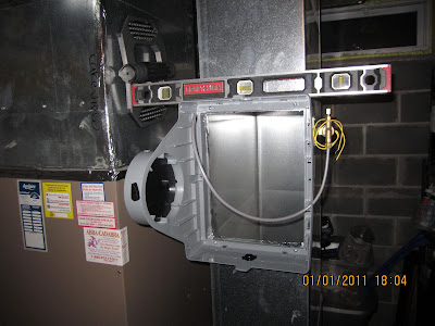

Old 01-02-11, 11:16 AM
J
Join Date: Jul 2007
Location: Sussex County, NJ
Posts: 123
Originally Posted by Jay11J View Post
Correct.
Black will go to either HUM 120v or ACC. (not sure what board for sure since the manual shows a few type of board that could be in this furnace. Then white wire will go the neutral slot. You can use 1/4 female spade on the wire.

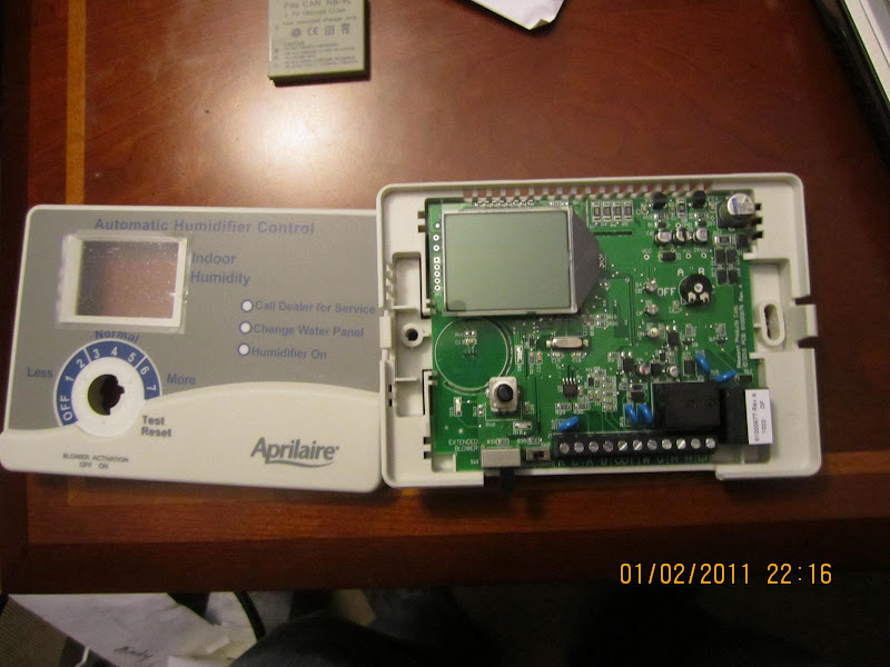

Jay,
Ive got the humidifier installed and im starting to wire it up. Ive located the ACC and Neutral terminals for the black/white wired on the transformer.
The opposite side of the transformer has two screw terminals labeled 10VA and 24v, from the wiring diagram it looks like one terminal will go to a yellow wire from the humidifier and the other to the "H" terminal on the humidistat, is that correct?
Also, the other yellow wire from the humidifier should go to the other "H" terminal on the humidistat? And it looks like it doesnt matter which yellow wire goes to the transformer or humidistat...
Other than that, I have the outdoor temp sensor going to the ODT terminals...and as far as I can tell, those are all the connections that need to be made??
Thanks,,,
I should have this thing up and running soon!!

What model humidistat did you get?

I have the Aprilaire 600 with the Digital Humidistat...
Automatic Digital Humidifier

There are a few digital that Aprilaire has. Is #60 or #58?
  #21

Ok....
After you asked me for the model # of the humidistat, I found the booklet in the bottom of the box, under the styrofoam. The humidistat instructions had the wiring instructions much more detailed than the installation diagram. I simply followed the book (and Jay) and wired the humidistat as follows
Transformer:
Black-ACC on Furnace
White-Neutral on furnace
24v side
1 wire to humidifier solenoid
1 wire to H terminal on Humidistat
HUMIDIFIER:
Yellow 1-24v side of transformer
Yellow 2-H terminal on Humidistat
HUMIDISTAT:
R to R on furnace
C to C on furnace
G to G on furnace (Note, G from thermostat must be removed from furnace terminal)
GF to green wire originally on furnace G terminal
W to W on furnace
Everything seems to be working well. I had a small leak at a compression fitting that I unhooked and added some more teflon tape...seems all good now. I have added ALOT of photos from the install process below...hopefully some of them will help the next person who has questions. Jay, if you see anything wrong with what I did, please let me know. Thanks for all your help!!

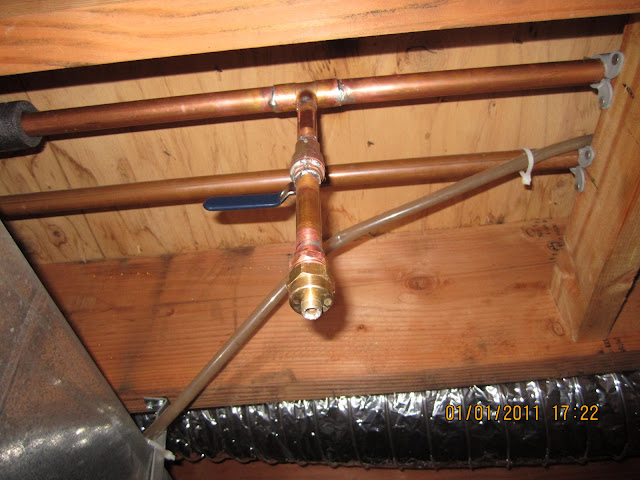

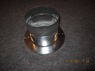

Continuation of install photos
ON the G to G, did you tie the T-stat's G to the humidistat?
Other than that, you did good for a rookie.

I connected the wire that was originally connected to the furnace G (which comes from the T Stat) to the GF on the humidistat...
Everything seems to be working ok, when the heat kicks on, the humidifier turns on and starts running. I have the blower activation switch set to off so that the humidifier only works with the heat on, not the fan. Ill give it a week or so and see how it is. I have it set on 5 and im at about 30%

No, The G wire from the t-stat goes to G on the humidistat. Gf from humidistat goes to G on the furnace.
