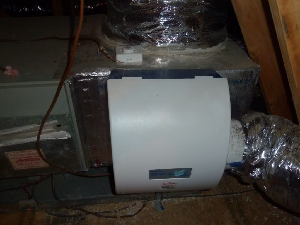

The humidistats are actually "in line" with the humidifiers, ie. not upstream or downstream. On the downstairs unit, it is sort of "jammed" just below the humidifier on the same face of the return. On the upstairs unit, it is on the top whereas the humidifier is on the side, but it is at the same point of the return.

Downstairs unit kinda bother me.. Can you please take a photo of both units for me?

The first photo is downstairs (crawlspace), second is upstairs (attic).
On the first, the humidistat is visible behind the drainage pipe. Incidentally, I checked where it's "on" point was just now, and it was up over 60, even though rh in the house is still just over 30%. So I've now moved it up even further to the "ON" setting (I guess the humidistat is currently useless). This humidistat is not secured with screws, it's just stuck into the foam duct at an area where there is no metal within the foam (I'm assuming the humidifier is just glued on). We aren't real crazy with the work the electrical/HVAC subcontractor did, by the way.
The second floor humidistat is visible on top of the return duct:

I don't like it how it's set up.
It don't seems like the downstairs unit is not really "bypassing"? Is the 6" side duct tied to the return still or is that the supply?
Where it's at on the upstairs unit may get a false reading...
As HVAC brought up, the humidistat may need to be moved to the living space.

It does bypass on both units - it's a long 6" duct that wraps around out of the picture to the hot air supply.
My guess is that neither humidistat can give an accurate reading of the room air because it's so close to the humidifier. Another problem is that the return plenum is just a little longer than the humidifier, so there isn't a space 8" upstream from the humidifier to mount it.
