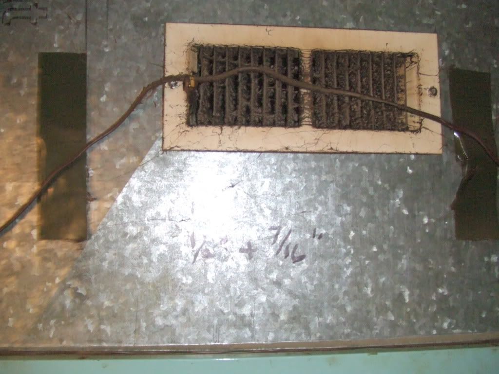

here's more

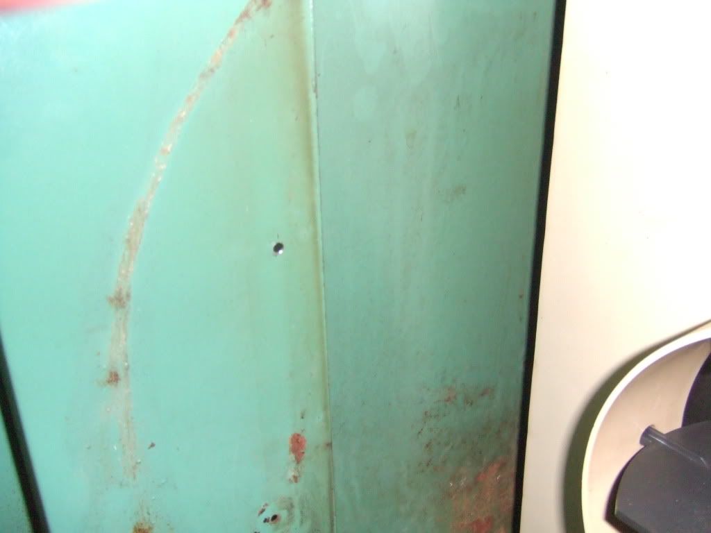

this shows the space on the side of the 600, it's 4" wide. you can see there's an inch from the back of the 600 to the side panel of the furnace. I could center up the 700 and there would be 2" on either side for the air to spill out. I don't know, if it don't work I'm out $200? man, I need to grind away that rust and put some good carbozinc paint on.

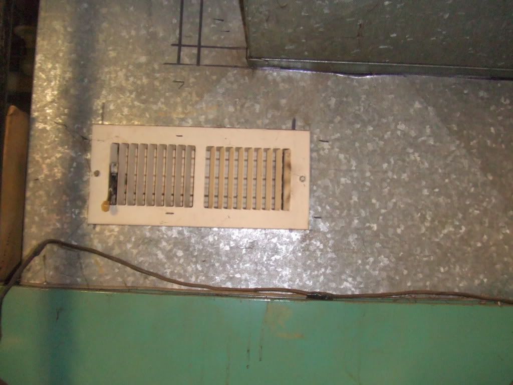

this is the return side
this is the supply side
the orter side of the furnace is not an option, one the opening on the 600 is on the left and on this side of the frunace the supply would be on the right. two, the amount of room is limited by the water heater and the furnace flue pipe, not a good option, almost up to the basemant wall, it's not in the center of the room like jay's gramps.

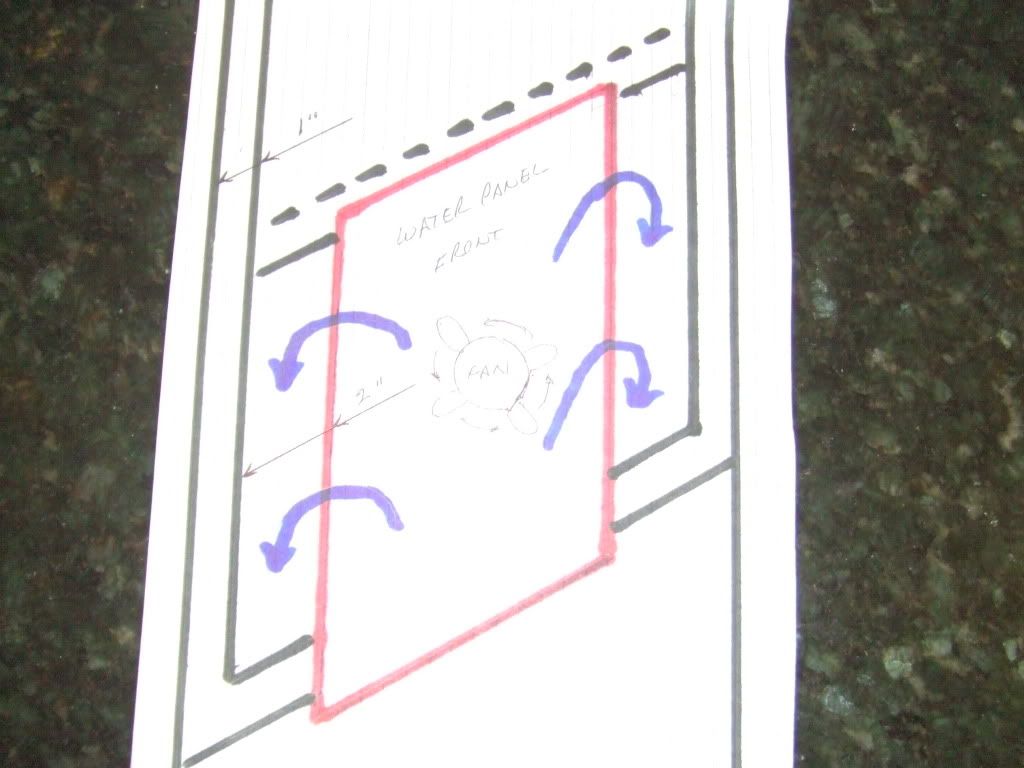

Friend Jay, yes sir, that's how I understand the operation of the 700 too. The air is drawn in from the cover side and discharged thru the backside of the water panel. The built-in fan is what blows the air over the water panel vs the way a bypass works. Other than that, the two units are identical; but the little fan of the 700 won't blow the intake so forceful as to cause my present situation. I guess my question should be whether or not there's enough area on the discharge to be effective. The water panel would sit one inch away from a dead-end wall and about there would be a 2"X13" opening for discharge air on either side of the panel. Am I explaining it good enough, I wish I could post a drawing, maybe I can? back to the drawing board. Thanks, Douglas

No, the air is not drawn from the cover side. It's drawn in on the side of the the pad side. and back out in the middle of the pad side.

both of you are wrong, jay is close, just backwards..........

here's what I'm thinking
according to Fred's illistration, the fan pulls (rather than pushes) the air from the backside of the water panel and it's then diverted back on each side and on into the return chamber. either way, i think it might work, the only thing I have is the volume of incoming air is reduced to only one inch deep, as opposed to pretty much unlimited if it was completely open to the backside.
Thanks, Douglas
It seems kinda counterproductive, you're drawing in some of the same air you just conditioned?

So the fan is actually connected to the cover? There must be some kind of quick disconnect for the wiring? Or do you just unplug it from the 110v and set the cover/fan and all aside when doing service? Thanks, Douglas

the fan is attached to the cover, Yes.
