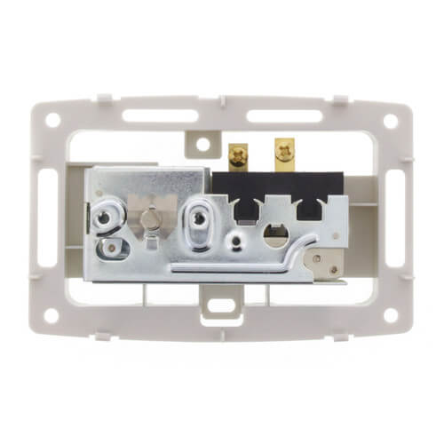

Thanks Astuff and PJmax for the quick response. I have another silly question, the humidistat has two terminals, do I just connect the live wire into one terminal and then out the other or does it matter?

It's just one series loop. There is no polarity on the humidistat or the solenoid.
