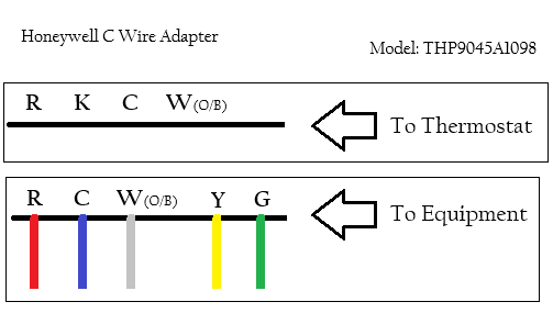

Note: The HVAC installer said I had to purchase a different thermostat to hook them together, whereas the manufacturer of the dehumidifier said it would work with Nest. I'm also not sure if the HVAC installer connected the 2-stage correctly (i.e. the W1 & W2 wires). Picked up a C-wire adapter just in case (was $1).

Picked this C wire Adapter thinking it may be useful?

Based on research on Nest thermostat's and this setup, it looks like an AC Adapter (24 Vol Transformer) hooked up to the thermostat RC and C wire might solve the issue.
  #21

Try moving the red R wire to Rc instead of Rh on the nest first.
Rc is the terminal that power is referenced to.
Do you have any other spare wires between the stat and furnace ?
If you do... connect C of stat to C of furnace.
  #22

Moved the Nest red R wire to Rc instead of Rh. No change.
Didn't see any extra wires.
Added AC Adapter to RC and C wire. Nest thermostat with dead battery came on and is charging.
Status when I plugged it in (thermostat)
Battery: 3.414 V
Voc: 36.86
Vin: 36.86 V
lin: 200 mA(c)
It works!!! Thank you!!!
