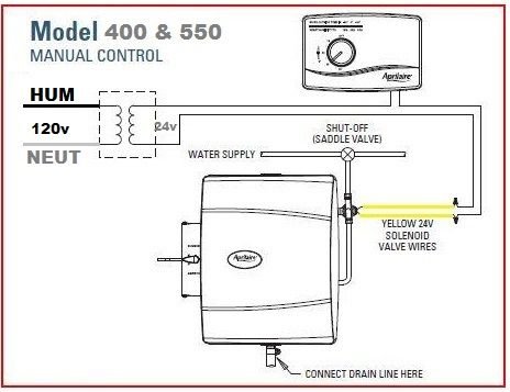

The HUM terminals supply 120v switched whether in stage 1 or stage 2 and the burner fires.
That 120v is connected to a small 120v ---> 24vac transformer which is used to power the humidifier.
It doesn't matter if you use a manual or automatic humidistat.
Actually it's better to use a manual h'stat because with W1 and W2 there is no single W to feed the automatic type humidistat.

This is an Aprilaire unit but is wired identically as yours.
It doesn't care about one or two stage or the thermostat.
When the burner fires it powers the HUM terminal.
  #22
