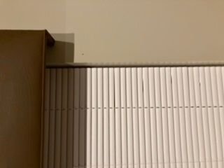

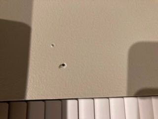

im getting these tiny slanted holes in multiple interior walls. Anyone know what itíd be from? Thereís no markings around on the floor etc. just slanted hole.

Looks like some one stabbed the wall with a scratch awl or small phillips screwdriver.

looks like a nail hole, are you thinking an insect? Ive never know anything to make holes in drywall/plaster!

I've seen termites in fla that chewed their way thru drywall but it looks nothing like that. I'm 99% certain that is something a human did.

What state/country is this? Geographic regions help with insect ID sometimes.
Could be insect. Termites will chew through dry wall to access wood or when they are exploring for wood. This does not look like subterranean termites to me so far, but further inspection would be necessary.
I'm not familiar with dry wood termites, which could still be a possibility.
More commonly are the wood-destroying beetles such as powder post beetles that emerge from the wood behind the wall and sometimes come through the dry wall. If this is insect, I'm pretty sure it's an emergence hole, not entrance.
Are there areas of the house such as basement, attic, utility closets, etc that have exposed wooden studs/joists/posts, etc? If so, they should be inspected thoroughly for the holes. If it is insects, then accurate ID will be paramount in order to determine type of treatment or even if treatment is necessary. If the type of insect simply emerges but does not typically re-infest, then treatment may not be necessary. You can see why proper ID is necessary. Be careful who you call, if you do, as many in the pest control industry aren't trained or experienced in the differences between species. Treatments can be very involved and expensive and well beyond homeowner ability.
Wood destroying beetles work slowly so don't react as if it's an emergency. Take your time and learn. Watch out for sales oriented pest control companies.
If you find exposed, infested wood, take pictures of it. Keep us posted as to what you find.

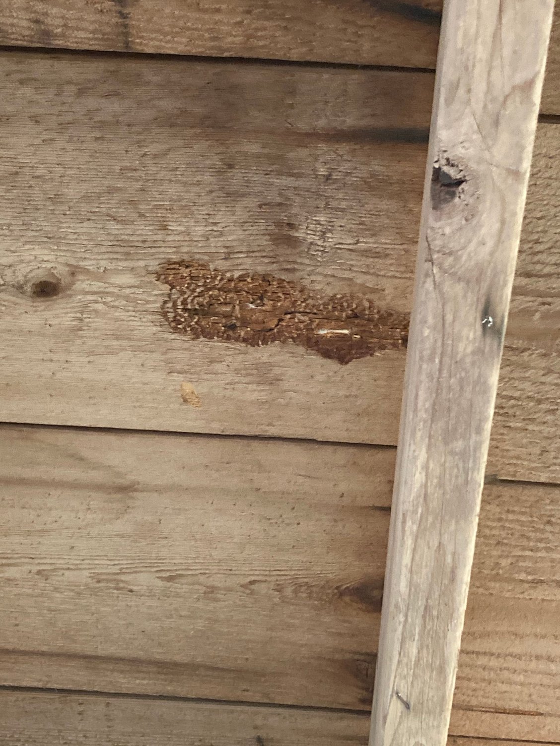

this is happening to my back deck roof, not sure if itís related, thereís not holes but the wood is definitely changing

The back deck pic isn't insect related in my opinion. It looks like a type of dry rot/brown rot to me. Did you probe or dig into it to see if it's soft and how deep it goes?

That's my thought also - a little bit of rot on the decking. That portion of the wood was probably softer than the rest and more susceptible to absorbing water.

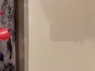

I havenít noticed these before, it looks like the start of holes ? Sorry images are all sideways. These are different walls in the living room. All at least shoulder height if that makes a difference

Sure they weren't from picture hooks? They use nails that are slanted.

That looks like somebody painted over nail holes or push-pin holes where a kid hung posters.
Unless you fill in the holes, (spackle or toothpaste) the paint over the holes will eventually pull away and reveal the hole.
