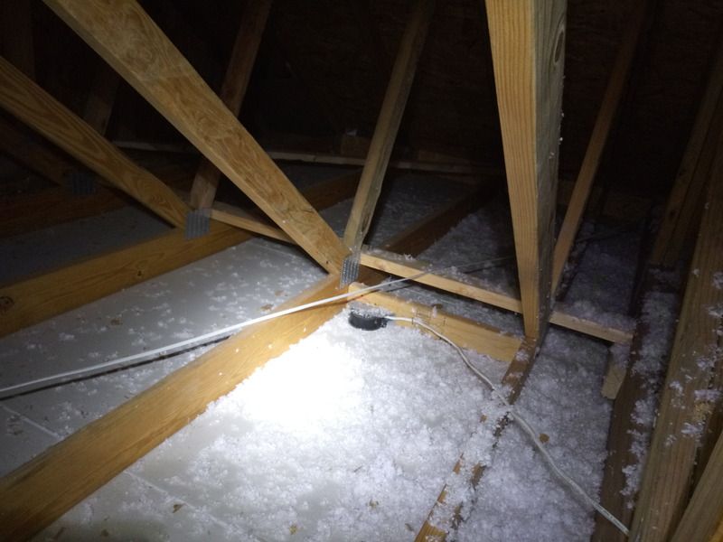

Just purchased a one level single family home that was built about 5 years ago. Upon entering my attic for other reasons, I noticed that one of the smaller bedrooms at the front of my house did not have insulation above it.
I am not an expert at insulation by any means and I am guessing that what is in the attic is blow in type or something similar. It is loose and walking through it pushes it all over the place.
My question is whether or not there is ever a reason to not insulate over a room like this. I ask this because I don't want to waste time and money adding insulation in the attic over the room for no reason.
It is definitely not the easiest area to reach, but it doesn't seem that hard where someone would have avoided it all together.
This room also runs about 5 degrees colder than the rest of the house which is heated by a Propane Furnace/Forced Air setup. This requires a space heater to be used in that room at all times to take care of the delta in temperature.
The HVAC guy advises that the temperature is lower in that room because the duct work is longer to that room than others. This might be correct, but I am sure that the lack of insulation in that room can't be helping (if there is indeed supposed to be some there).
Would pictures or additional information help? It will take me some time to get a picture up.
Thanks for any input.

Pictures would be interesting. Given the probability that they just missed this area, very low, then where did the insulation go. One possibility could be a critter. Raccoons have been known to destroy insulation in their efforts to customize an attic to their needs. Does it look like there is a lot of insulation piled up in another area?

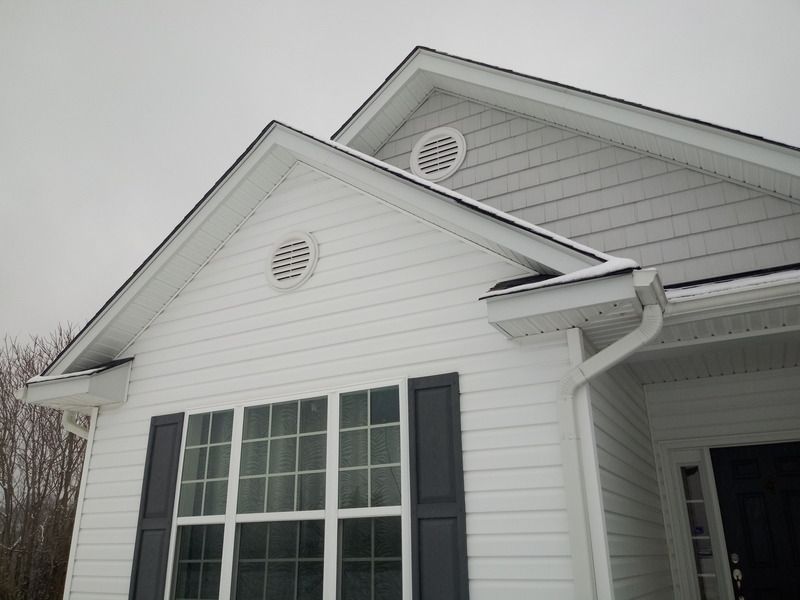

Depending on the size/shape of the room, if there is too much soffit ventilation, strong winds can blow the insulation right off the ceiling... or at least away from the perimeter. If that was the case it would usually be piled up in the soffit.
This is a great reason why people who say "you can't have too much ventilation" are dead wrong.

Too much missing to be a coincidence. Pictures give the impression that there was some insulation effort. In reality, this is just spillover from the rest of the rest of the attic which has about 13 inches of insulation.

Wind as X mentioned is a possibility but you would see it piled up somewhere nearby.

Also, there are 2 gable ends right above this pretty small room. I think that might not be excessive for the entirety of the house as a whole but it sure is cold up there.
I guess that I should not block these?

You posted while I was typing, but attics are supposed to be cold.

Here is the deal. According to the current energy standards in most locations, attics should have R-49, and with blow in insulation depth sticks are often required to give a visual representation of the depth. That "should be" 16.25" of your ProPink L77.
Yes, you could put unfaced batts in to achieve that R49, however you would be spending a small fortune to achieve R49 and you would need to do it in layers... first filling your trusses to the top of the bottom chord, (such as with R19 or R21) then laying an additional layer perpendicular to the first across the tops of the bottom chords, (such as with R30) while cutting around all the obstructions with each layer so that there are no voids. Have you ever tried to move around in an attic on your hands and knees? Not easy. Plus you can easily put a foot through the drywall if you aren't careful.
No, you do not "have" to use the same insulation as what is there, but there are some benefits to blowing fiberglass. More economical (costs less)... faster... no cutting or notching... safer.
As far as being itchy, that depends on the person. No, it is not like the fiberglass from the 60's that was comparatively heavy and seemed to have pieces of actual glass in it. That stuff was bad! I have no problem working with fiberglass insulation, but everyone is different. No matter what type of insulation you choose, you still might want to wear long sleeves, gloves and a respirator. Those things can't hurt.
And as far as how they did it before blown in became popular... yeah they laid in batts. And the effectiveness of the insulation was directly proportional to how good of a job they did at installing it... you got gaps everywhere and air leaks around things that were hard to cut around. With blown in insulation there are no voids and less air infiltration. Its like covering your ceiling with a blanket vs. having a coat on that is partially unzipped.
If it was my house, there is no question I would rent the machine and blow it in. With a helper it would take longer to go get the materials and unload them than it would take to blow that small area in.
The price difference plus the labor makes it a no brainer.
If you buy it at Lowes or Home Depot, blown in insulation (at R49) costs about $1000-$1100 per 1000 sq ft. Plus the machine rental is free for 24 hrs.
If you buy batts, as mentioned above the cost for the same area (1000 sq ft) is about 50% higher. $1500-$1600, depending on the product you buy.
(Not saying you have 1000 sq ft, just using that as an easy number to figure and compare.)
And any small room that is surrounded by exterior walls on 3 sides will be colder than the rest of the house. Just saying... there is more exterior walls in that one room than any other room in the house with only one or two exterior walls. So no, just adding insulation to the attic is not going to make the room instantly warm, but it will help and it definitely needs to be done... no question about that.
Bud's idea about calling the installer would be a good first step. That insulation didn't just disappear into thin air.
