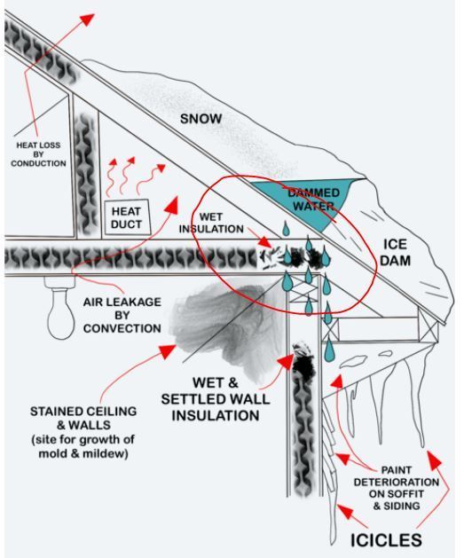

I had my house weatherized last fall. Pertinent items that were done include removing rafter insulation and insulating the upstairs knee walls instead, combined with 20 inches of blown cellulose behind the knee walls and along the flat midline of the attic space. 2 new vents were also installed. My energy use seems significantly less, but my ice dams are the worst I have ever seen them. Much, much worse. They have gone from bad to severe.
Coincidence? Warmish weather this winter may have contributed, to an indeterminate degree, but I thought my ice dams would be greatly reduced not increased after weatherization. I've got icicles coming out of the soffit vents in a few places, which is a bad omen.

If you have increased the insulation in the attic..... then you will need to confirm or increase air flow thru the attic. The roof deck needs to be cold or you'll get a lot of melting snow and ice dams.

If your attic space is warmer the roof deck will be too. That can lead to more melting on the roof. But if you have a lot of snow and a lot of melting that could be the real reason.
You need to have plenty of ventilation between the insulation and the roof, and fresh air to keep the roof deck cold. Ice coming out the soffit vents likely means you don't have adequate ice and water shield under your shingles. If the ice is coming from the attic the likely culprit would be poor air sealing prior to adding insulation.
20" of cellulose is around R60, you should not have any significant amount of heat loss through all that, cellulose is also very effective at air sealing, should be a much better situation over what you had.
It's difficult to know exactly what your insulation system was before but ice dams are as much about sufficient insulation as they they are about where that insulated exists.
The areas at the corners of the rooms, right at the top plate is a trouble spot. If the prior insulation was sufficiently packed/folded into these areas but was removed and new insulation was piled onto the ceiling but didn't get replaced in this area then greater heat loss will result creating worse ice dams.

This is about what my ice dams look like right now (that's not my house). Very nasty.

Need to see your house to judge the ice vs the construction. The house pictured has a severe heat loss issue into the attic. You said the roof is ancient how old is the house.
My current thinking is you have a ventilation issue related to the insulation work they did, but need a picture or two.
