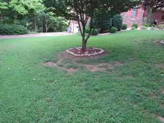

I live in N.W. Alabama and have lawn consisting of mixed grass mostly bermuda and fescue.
I had the soil tested and it came back as only needing Nitrogen.
My lawn has many bare spots where there are only a few (healthy) sprigs of bermuda or fescue.
I have never encountered a problem like this and there seems to be no insect problem. Most of the areas are in partial shade and some are in almost full sun. I have watered these areas thoroughly.
Strange thing is--Early spring, I sewed these areas with fescue and it came up in just a few days and grew to about the second mowing and now it is all but gone and the native grass is coming up in small areas.
Entire lawn was fertalized with 0-0-33 before sewing grass, and water doesn't seem to be the problem.
Any suggestions would be appreciated

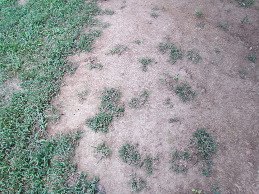

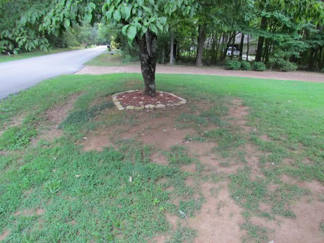

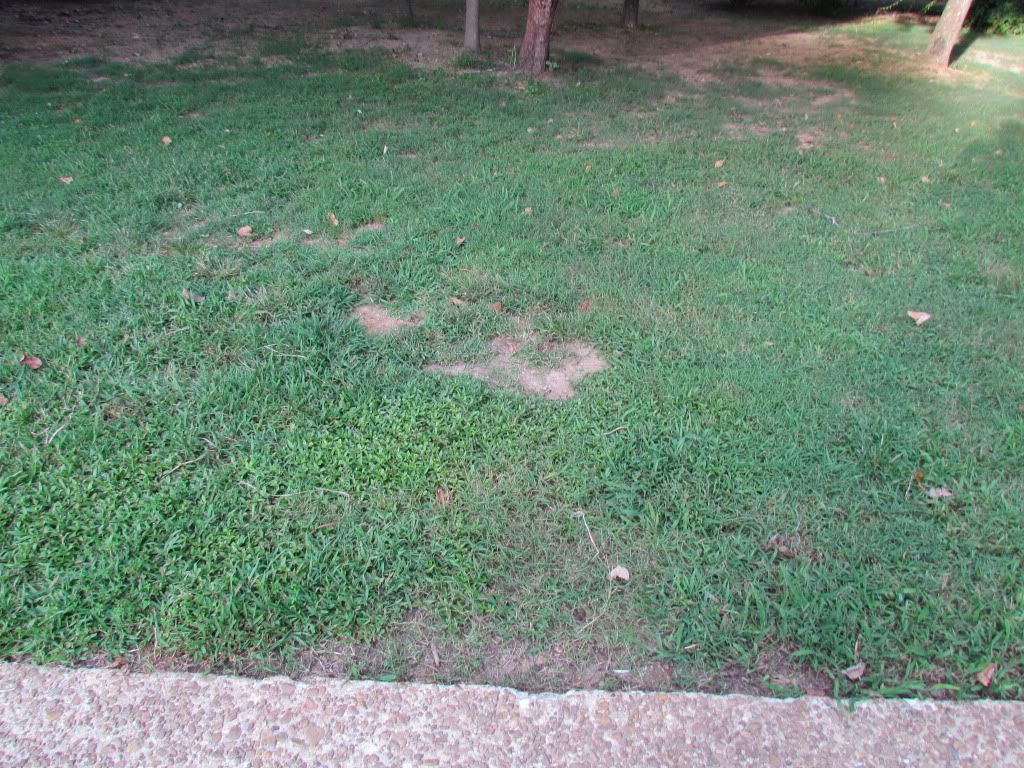

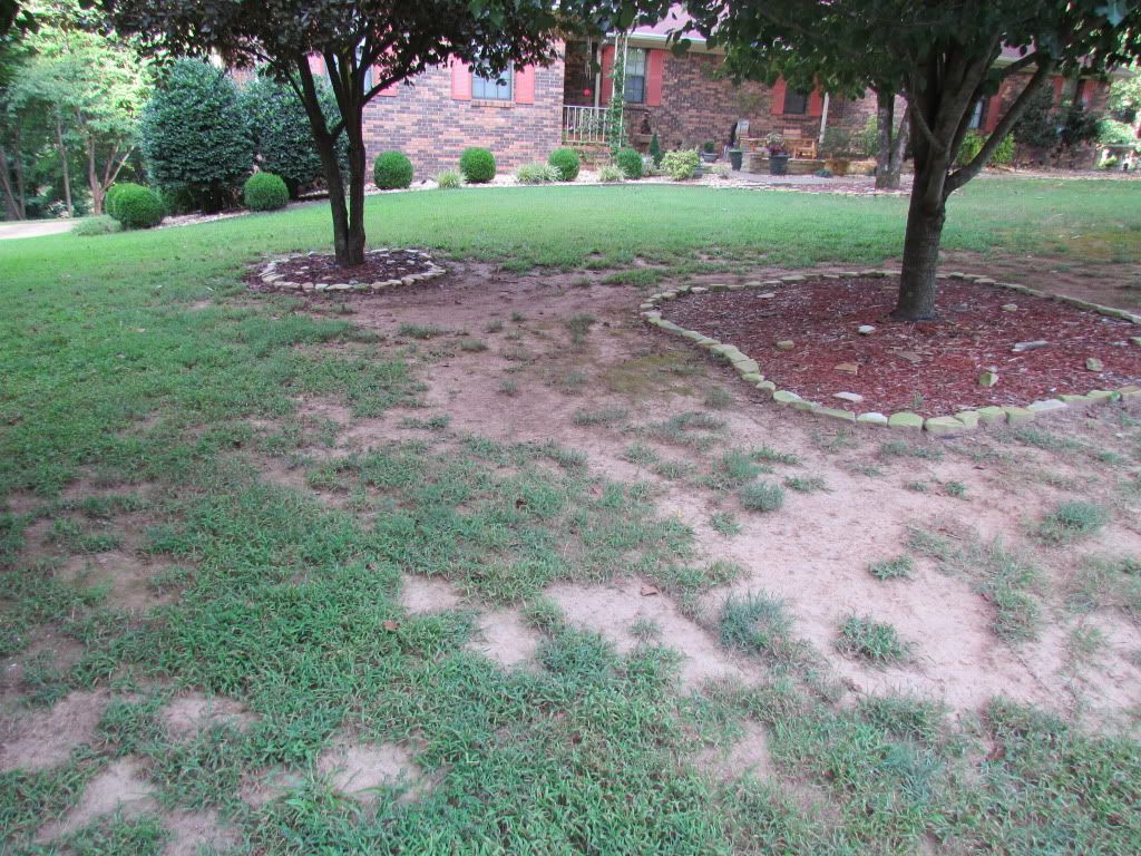

I hope these photos help to identify my problem

It does not look like a disease or at least one that's not visible now. You don't have anything but bare dirt. I wonder you might have sowed rye. Maybe a mislabeled package. It quickly germinates and grows fast but it dies when the summer heat arrives. Once we are safely past the extreme summer heat I would try once again to seed those bare areas. Maybe do a large section so you can get in with a tiller to loosen the soil.

No grass has been sewn in these areas. The problem is getting worse because it definately wasn't this bad last year. After the soil test, I felt sure the grass would rejuvinate after the correct application of 0-0-33. I thoroughly water every Two-- THREE days and some of my areas are better.
I realize that mid summer is not a good time to sew new grass so it looks like my best bet is to work with small sections this fall after breaking the ground.
As you can see from the photos, the grass in the bare spots is healthy and is growing but not spreading.

Not having anything growing at all (including weeds) makes me think the soil is compcated. You could core aerate but since there's nothing there anyway to disturb, I like Dane's idea of rototilling before you seed again.
