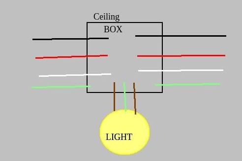

I'm installing a light to the ceiling and I'm trying to figure out the wiring so that it can be turned on/off at two different switch locations. I'm given (from the ceiling) one black,white,red and green wires (which I know is the ground), and another set of the same wires. The ceiling light has two wires. Any thoughts on how I do this?

The wires were already hooked up to both switch locations. 4 total wires including the ground wire on each switch (two switches, 4 per switch, 8 total wires)
The other end of those wires are coming out of the ceiling ( 8 total wires) One set has black, red, white, green, from one switch and another set from the other switch. I need to hook those up to the ceiling light.
The ceiling light as only 3 wires. Two brown (literally brown color) cheap quality it seems, similiar to a lamp wire, and one ground wire.
First when I refer to wires I do not count the ground wires. Sorry for the confusion. So that we are clear based on what you wrote You have three wires plus ground at each switch and six wires and two grounds plus the light's wires at the ceiling. Is that correct? Can you post pictures to Photobucket, Flikr or Imageshack.us?
For this to work you need to get power from some where. That is a hot wire and a neutral. You don't have enough wires for this to work. Did it ever work?

Nice,
Yes , the diagram is 100% accurate.
The light did work, BUT, if the one switch was in the off position, the other switch wouldn't be able to turn on the light.
Let us know what you want to do and we will proceed from there. You will need an analog multimeter or test light or Wiggins (solenoid) voltage tester.
