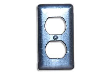

When you say to replace them with receptacles, I am not sure what exactly do you mean? Right now there are wooden beams in the basement ceiling, and screw base bulb sockets (just like in the picture in the link) are attached to the beams. If I remove these sockets, I think I will be left with just the electrical bare wires.
http://www.electronicplus.com/images...cts/659-SP.jpg

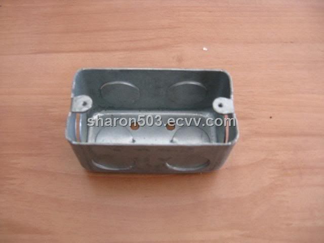

If I am reading this right you do not have any junction box above the keyless lightsocket ??
This what the typical junciton box look like
Typical this is one of most common one it will look simauir to this and you must have them when you use the keyless socket or other type of luminaire or other devices.
This is a serious issue you need to deal with it.

If you don't have junction boxes then I would suggest removing the keyless fixtures and installing single gang handy boxes with receptacles so you can plug the lights in directly.
