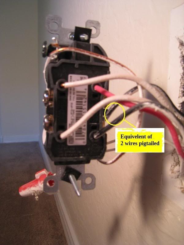

Lets get some terminology straight to make this simpler and clearer for everyone. No need to mention ground wires. They are not relevant for this discussion. We will assume ground wires are there and connected. When you write:
You really mean a pigtail, a short length of wire, connects to the switch.
That bundle of black wires pigtailed to the switches contains your hot wire for everything. We don't really need to know which wire just that that is the hot bundle.
I’m going to throw you a bit of a curve ball now. Remember when I said there might be a different way to make the switched receptacle always hot. Well I'm going to suggest doing it another way. Are both of the plugins on the receptacle hot? If not post back. If so open up the receptacle. If it has a red wire to one of the brass screws and two black wires that are connected with a wire nut but not to the receptacle disconnect the red wire and cap with a wire nut. Connect one black wire to each blrass screw, Turn the breaker back on and test. The switch should no longer turn it off and on.
I'm going to stop now and wait for you to post if anything was different from what I said. If so just stop, don't do anything and post back and then we will continue. If you get as far as converting the receptacle to not switched I'll continue with how to put fan and light on separate switches.
The black wire runs to a wire screw cap, and then comes back out to the switch
In any case I am going to provide several pictures in hopes that from the pictures you can see what it is you are looking to determine, and then perhaps you can explain it to me?
Thanks Ray! Heres the pics some are bad quality but hopefully with all the pcis you can piece together a full picture of whats going on:

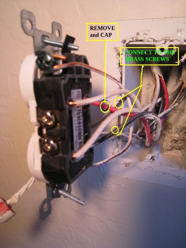

See edit at bottom before starting.
First let me recommend a bit of house keeping on your receptacle. Use of the backstabs for connection is not recommended by most in this forum because the connections tend to have a higher failure rate then screws so move the white wires to the screws.
Remove the red wire and cap it.
Move the back stabbed black wire to the unused brass screw. You should already have a black wire on one screw.
At the switch for the receptacle remove the red wire and cap with a wire nut.
Check that there is a pigtail from the bundle of hot wires to the switch.
You have a three conductor cable from the fan/light fixture. One already goes to a group of white wires. Leave that as is.
One wire goes to the fan/light switch. Leave that in place.
One wire from the fan/light goes to the hot wire bundle. Remove that wire and connect to the un-used terminal on the ex-receptacle switch.
At the fan put the blue wire back where it was.
Note if they used back stabs on the switch it is best to move the wires to the screws but not required. Tech note:: A backstab forms a connection pair with the screw nearest it so if you have a wire on the screw and one in the backstab they are connected just like a pigtail. I point this out only so you will better understand what you had on the receptacle.
Edit: You are going to need to replace the receptacle if the tab between the brass screws is broken and it should be for the setup. I missed that, sorry. All else remains the same.

Well I tried to follow your directions to the letter, but obviously I went wrong somewhere because now nothing works!
I have attached pictures and diagrams of what I did. The switches do not turn anything on now, and I changed the wires back to the way they were inside the fan. I moved the blue wire back to the black wire.
As for the wall outlet. It only has one plug that is hot, which is shown in pics below.
WALL SWITCH:
WALL POWER OUTLET:
At least I havent electrocuted myself or started any fires yet!

The red wire in the cable to the fan goes to one of the switches. I see two disconnected red wires. There should be one.
Are you sure you have a pigtail from the bundle of hot wires to each of the switches.
Did you replace the receptacle? The one that was there had the tab broke between the brass screws. You could jumper the screws with a wire in the two back stabs on the brass side just to test.
Let me explain another way. There should be a pigtail from the hot bundle to each switch.
The red from the fan/light goes to the other screw on one switch.
The black on the fanlight goes to the other screw on the other switch.
The receptacle must be replaced or jumpered.
The red wire from the receptacle is capped.
The black wire from the receptacle must go to the hot bundle at the switch.

Join Date: Oct 2009
Location: arizona
Posts: 38
Received 0 Upvotes
Ray! You are the man! Beer 4U2
After reading your post several times and looking at everything again the light bulb finally went on - some pun intended! ;-)
Everything is working like a charm thanks to you, and pcboss! I would have never attempted something like this before, but it was actually a lot of fun, and I learned a ton! So thanks for all your help and patience. I know its painful dealing with newbies. ;-)
