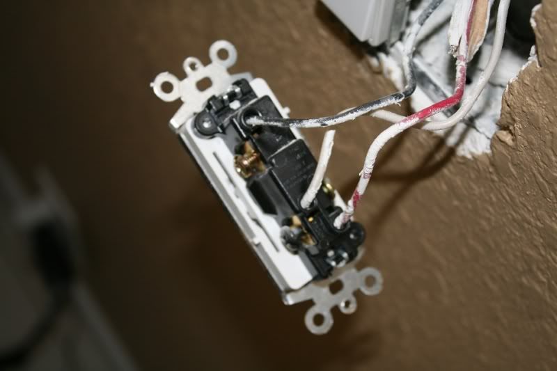

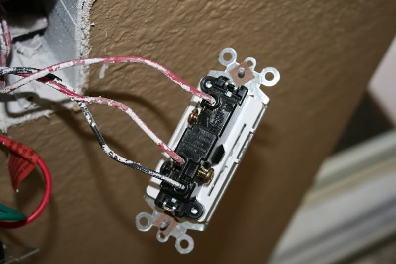

Ok... Here are some pictures I took of the switch wiring.
This is SWITCH #1 (based on the diagram provided below).
This is SWITCH #2

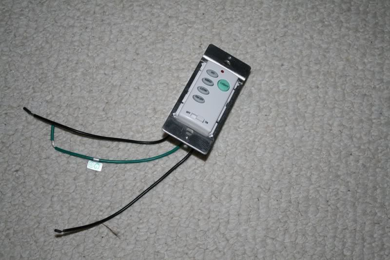

Here is a picture of the fan switch that I will be connecting. It's got 2 BLACK wires and 1 Green.
Any help here would be greatly appreciated.

We need to see all the wiring in each switch box.
I didn't take any pictures of the wiring coming out of the ceiling where the fan is but there were 4 wires total:
1 Green
1 Red
1 Black
1 White
How are those wires curently connected? Is one not connected?

That would indicate you have a switch controling the light and one controlling the fan. If one of the switch boxes has only one 3-way switch that means probably either the black or red wire to the fan is controlled by a switch that is not 3-way. You can replace that switch with your new switch and just abandon in place the two 3-way switches.

Im 99.9 percent sure this is a REMOTE CONTROL unit and you would need a fan or receiver unit to match it. In your other topic you said you had a hunter fan, So thats what im going off of
