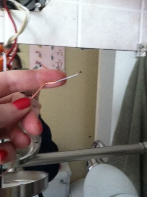

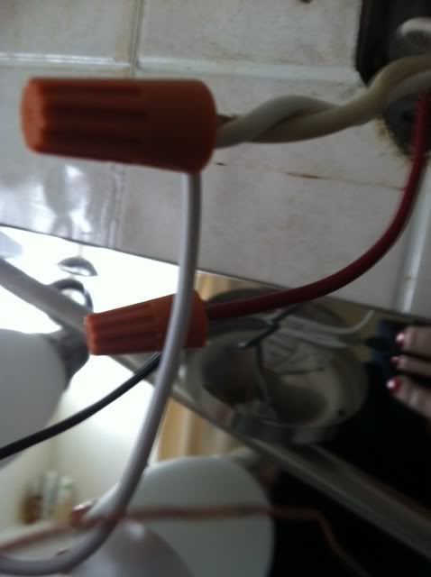

Thanks for your suggestions!!! I have pictures now!!! please tell me if I'm on the right track.
Here's what I have hooked up:
Here's that pesky ground wire:
I have no idea what to do with this ground wire:
This is where I am now. (Don't worry, I turned off the breaker. eek!!! my hair is already wild enough!)
Again, thank you for your patience - I know this may be a "lower level" question but I'm SUCH a newb!!!!!
And thank you again for your help!!!! His mind will be blown!!!

The ground wire gets connected to the bare copper wire in the box.
Everything else looks correct.

You seem to have a white and red together. That would be a dead short. The red needs to go to the black of your light. The white of your light goes to the bundle of whites.

Looks Ok to me Ray. See the first picture.

Our posts crossed. That first picture wasn't there I swear but what's with the second picture that seems to show red with white? That was what I was writing about.

Yup I have hooked up red - black, white - white! Maybe its just the way the picture was taken.
