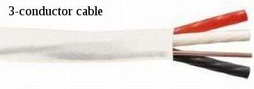

I reread your first reply. Perhaps I misjudged it. Perhaps you thought there was only one way it could be wired. Actually there are multiple ways and without knowing which of those ways it is impossible to answer. You didn't initially mention adding a second switch. That would be virtually impossible with out adding a cable.
He is trying to not only get it to work, but change it so the power comes in at the switch.
That would make things harder to do and require new cables. Why does he want to do that?
SO my husband hooked up two toggle switches (one connects to a light; and the other one is supposed to connect to a light/exhaust fan combo fixture).
He would need a new cable for the new switch unless you had 3-wire cable with an unused wire. Did he add a new cable?
t goes solely to the light and I turn the power back on, the light 'lights up'. When he connects the wires to the 2nd toggle, and I turn the power on, the power on the circuit breaker automatically turns from back to 'off'
As Dane said a dead short. It sounds like he connected a neutral to a switch.
Lets go back to the beginning. How many 2-wire (+ground) cables in each box (switch box and light box). Were there any 3-wire (+ground) cables in the boxes. How were the wires connected when you started.
2-conductor (2-wire) cable
