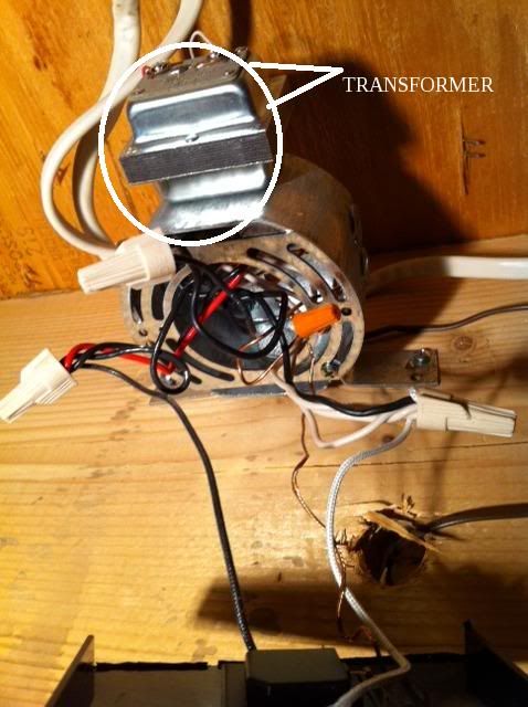

I apologize for my inability to describe this better... I am a total fish out of water here. I know this is probably relatively simple... I obviously goofed at some point. I'll include some pictures in this post.
Let me preface this by saying that that there is only one light switch. It used to turn on and off 5 lights in an unfinished part of our basement. We had a contractor divide that space in half. After he was finished, the switch only turned was linked to three lights (he added another switch in to control the other two. Fast forward to now. I wired 7 monopoints... 6 of the boxes that the monopoints are attached to are new (installed by me)...the only one that I didn't change is the one that I am including in the pictures. This is the one that has a bunch of different wires running into it. My intention had been to remove the wire that ran from the first light to the old second light and add in a new wire coming from the "new" second light (monopoint) in it's place. I'm almost positive that I did that. In my head, I thought all I had to do was fully wire and install 6 moinpoints... then cut the power... move the light box for what is going to be the first monpoint... remove the old wire that ran to the old second light... insert the wire that runs to the second monopoint in its place and voila! I would have a quick and dirty replacement! But, maybe I didn't wire it right. Something tells me that the problem lies here.. in the first (pictured) light box.
Do you see anything? This is so frustrating! Wishing I was an expert...
[IMG]
[/IMG]
Thanks. (very much!)
[IMG]
Could you give us a picture of the switch box also.If I see the wires at the switch I may be able to solve the mystery. I think I see the problem but need to be sure of the switch wiring.
The black wire with the whites is from the transformer correct? If so in the future lets no mention it.

Thanks for looking at the photos...
In answer to your question about the black bundled with the whites --- I don't know. I'm pretty sure that I found it that way...
I wish I could go back in time and open up that light box for the first time all over again!

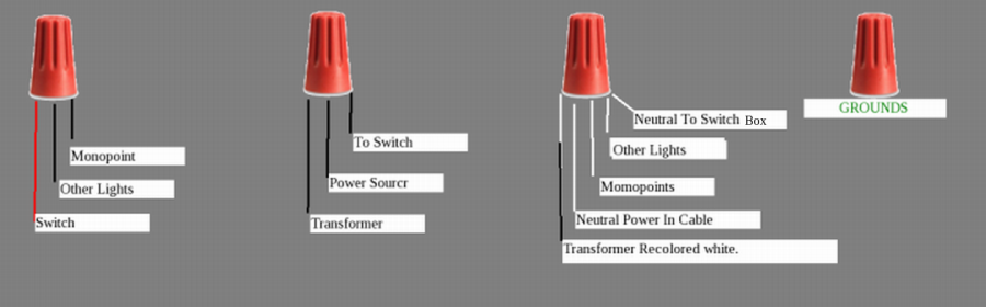

Try connecting the red in the light box only to the black wire of the light and the black of the cable to the next light. All remaining blacks are connected together but separate from the light wires. The light whites connect to the other whites.

Just to clarify... I should unbundle the wires that include the red wire (in the light box)... I should then wrap the red wire and the black wire from the monopoint AND the black wire of the next light together and cap those off (Red, Black monopoint, black next light).
Next, bundle together all remaining black wires (does that include the black wire that is currently bundled with white wires in the right hand side of the picture?).
When I'm all done, you're thinking that I should have four separate bundles in the light box:
1)grounds
2)Red wire + black from monopoint + black from wire leading to next light
3)All remaining black wires including the black wire currently bundled with white wires
4)ALL white wires
1)grounds
4)ALL white wires

Okay... I think I understand the wiring... I don't quite understand the "transformer" references... quite honestly, I look at this nesting of wires and I see two wires coming from the light switch... two wires running to the next light... and two wires running off in the direction of the other lights in the basement (which are now on a separate switch). At the switch I see three sets of wires running to the switch. I'm assuming one set is carrying the power to the switch... the other set is running to the lights... and I have no idea where that third set of wires goes.
There in lies the difficulty of trying to explain something like this over the net, when I need the "2 year old" explanation!
A simple mystery, I'm sure.
My plan is to do my best to move the wires around per your recommendation... re-bundle them and then turn the power back on. The worst that can happen is that the circuit breaker shuts power off again, right?

Ray,
Thank you for your time AND your help.
I took the wires apart... re-wired everything... and IT WORKS!
Thank you.
Thank you.
Now, I have a new issue... three of the track lights came on. Four were out. It turns out, that the other 4 will turn on if you begin to dis-engage the track light and twist it out of the monopoint. The second I re-engage the track light into the monopoint, the light goes out.
Very strange.
I check polarity, and they all seem to be aligned correctly. The Monopoint bases and the track lights are all from a matching series.
Hmmm... ever seen anything like this?
Again. Thank you for studying the pictures and coming up with a solution.
Regards,
Tsand72
#24
