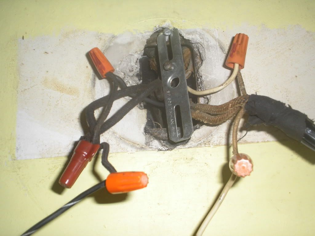

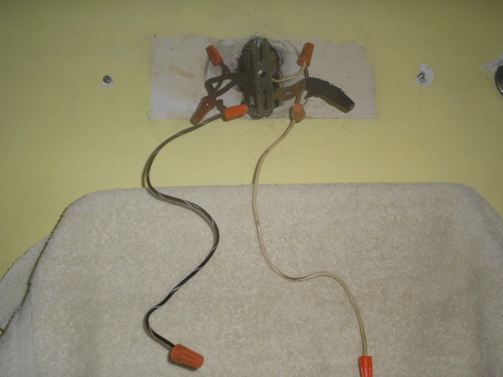

I am having trouble wiring this for a light fixture. If I put all white together and hit the switch it blows a fuse in the basement with a buzzing sound. I am so confused. Pictures might help a little.

Welcome to the forums! I know you have already heard this, but how was it wired originally?? You have a cell phone and didn't take a picture of it, right? OK, to basics. Most likely one of the white wires is really part of a switch loop and is not considered a "neutral". With the power off, pull the switch from the wall and see if there is a black and white wire attached to the switch. If so, you will need to, via multimeter, determine which of the wires in the fixture box matches. Where the wires are taped together, remove the tape and replace it with a proper wire nut. Seems as this was 1950's wiring. With all the wires, does this feed another light or receptacle??

The white wire that is in the top left hand corner of the picture is the switch white wire. It only feeds one light in the bathroom. I will cap the other black wires. Whats next? By the way my dad does not remember how it was wired.

I see black and white in your photo of the switch. So follow my instructions in the previous post. Warning: You must be sure what wires are from the switch. To do that, turn off breaker, mark all wires so they can be reconnected the same way and disconnect all the wires. Turn the switch on (breaker still off) and using a multimeter determine which cable has continuity. To verify you have the correct cable have some one turn the switch on and off. The meter should show continuity/open as the switch is flipped back and forth.
First wires on the top are switch wires. white on white. Black on Black.
I then connect the fixture and everything is fine intill the put the switch on. Then I get the fuse trip.
Advice or do you see anything wrong?

What you are doing now is getting power to the switch threw the black wire in wire nut #1.
Your light works now because you have it wired up -- white (#6) to white(neutral) and
black to black (power). But as soon as you turn the switch on / off you are in reality
connecting the switche's black wire (power) to the switche's white
wire (neutral) This makes a dead short, that is what's blowing your fuse...
I would take the White & Black wires from the Switch out of Wire Nuts # 1 & 2.
Where the Black wire was in Wire nut # 1 put the White wire from the switch
in Wire nut # 1.. leave the switch black wire just hanging for now...
Undo wire #3 (wire to the light) from wire nut #4, also remove the small jumper
wire #9 from wire nut #5 going to wire nut #4....
Now take wire #3 and wire nut it to the switche's black wire..
Wire # 7 looks like a new jumper --- remover that jumper wire
and wire nut wires 6 & 8 together...
Your light should now work!!!
Hope this helps----Let us know how your wirring project came out.
