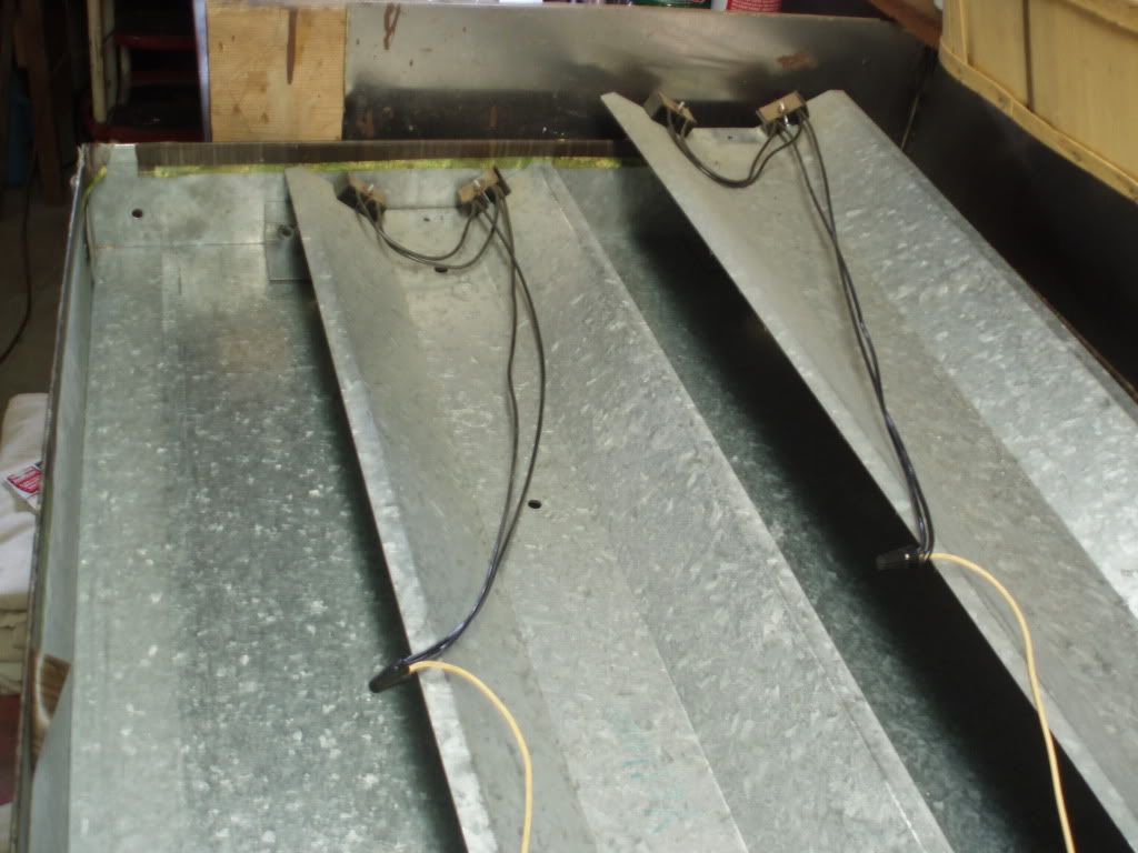

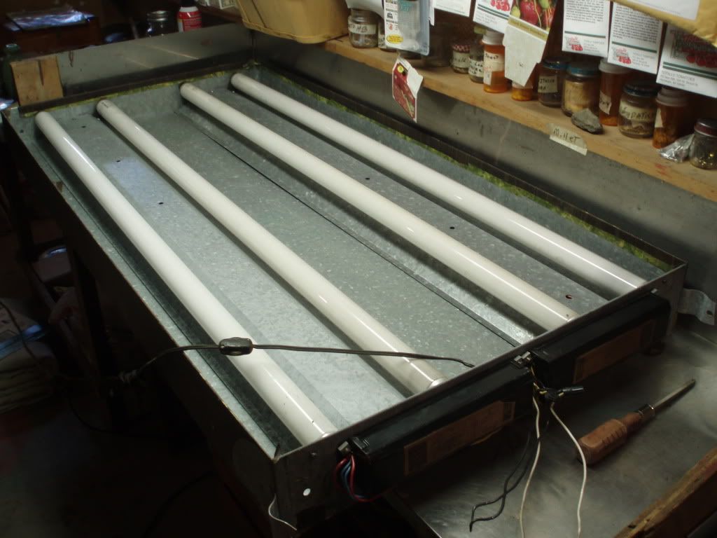

Here are a couple of pictures:
P2190315.jpg picture by pporto_522 - Photobucket
P2190316.jpg picture by pporto_522 - Photobucket
One is the whole grow light assembly. The other is the top unit upside down and with the cover over the ballasts removed.

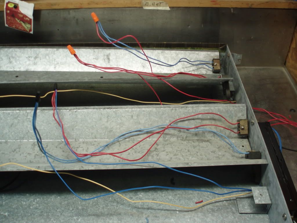

Seems pretty straightforward, but I thought I would show you guys my wiring before I went live.
Also, the bulbs I bought say F32T8/DX, but the only two 32 watt bulbs mentioned on the ballast label are F32T8/U and F32T8/DX. Is that OK?
[IMG][/IMG]

That should be fine. Just follow the wiring diagram on the ballast and your golden!
Did you buy a 4 lamp ballast?

I bought the ballast that you recommended: 4-Lamp T8 4FT Electronic Resi 120-Volt-71038 at The Home Depot

You likely have this done, but if you are confused, then I just wanted to let you know that if the diagram shows one wire going to the lamp holder and you have two, you just splice them all together.
IE: In your pictures I can see you have two reds or two blue wires coming off of one lamp holder. Just splice them together and then connect them to the single red or blue off the ballast.
Good luck! Let us know if you have any issues.
EDIT: I see you have it installed already in the picture. Looks correct.
