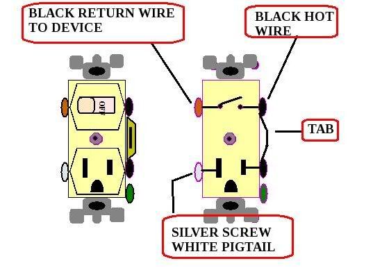

I need to replace an existing single pole/throw switch, in a double gang box, with a combination switch, and on the new switch, i want the plug to be hot, and have the switch controlling the light.
The existing set up is two switches, each controlling one light. As far as I can tell, without pulling them completely out of the box, is that the negative wire is used as the "breaker" wire for each switch.
How do I wire the new switch. I bought a Leviton T5225 for this.

How many cables enter the switch box? How many wires, of what color, are in each cable? Which wires, by color, from which cable(s), are connected to each switch?

There are 3 wires coming in, that look like standard house electric wires.
All three have 3 wires inside them, a white, a black and a copper wire.
In this setup, all three of the white wires are tied together.
the copper wires are tied together and there are two leads that go to the ground terminal on each of the switches.
the black wires - on the switch I don't want to replace, one goes to top common terminal, one into the bottom of the switch, there is a jumper black wire from the bottom common terminal to the switch I want to replace. It goes into the bottom of the back and then the 3rd black wire also goes into the top back of the switch I want to replace.
Hopefully you can figure that out. I didn't pull it all out, just took the cover off and tried to figure out what was going where. For certain though, the switch I want to replace only has the two black wires connected to it.

One black wire should have two pigtails with one pigtail to each switch. On the combo switch/receptacle the pigtail you are removing goes to one of the two brass screws that have a tab between them.
You add a pigtail to the whites and connect it to the silver screw of the receptacle.
The individual black wire from the old switch goes to the brass screw of the switch that does not have a tab connecting it to another screw.
<img src="https://i278.photobucket.com/albums/kk116/ray2047/Combo_SW_RECP_TAB.jpg" width="537" height="389"/>
