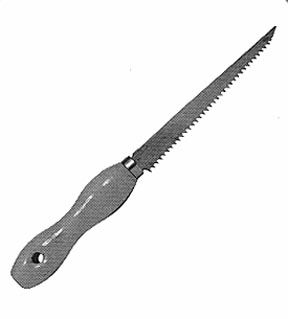

I am guessing I have to bust out the sheet rock to replace the box
No. Trace the outline of the new box on the Sheetrock and cut as much as you can with a Sheetrock saw (AKA Jab Saw) then carefully cut the part over the joist with a wood chisel.
