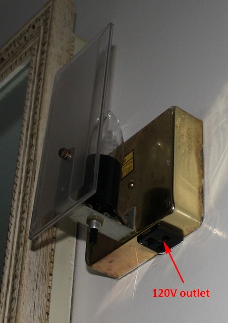

Hi,
Sounds easy doesn't it... Here's the problem... Take a look at the photo below...
I need to have the new sconce more or less match the current wiring scheme, but, I don't want the power going to the 120V outlet in the sconce to go out when the wall switch is turned off. (Right now, I've got a night light plugged into the sconce, but when I turn off the sconce light, the entire sconce goes dead including the 120V outlet and hence the nightlight...)
Is there any way I can keep the sconce 120V outlet alive, even when the wall switch is turned to 'off' for the sconce light, or do I have to replace/rewire the wall switch itself to included a seperate 120V outlet?
Thanks in advance...
Alan

Depends upon how it is wired. If power comes to the switch first and then travels to the sconce then no. If the power comes to the sconce and just a switch leg to the switch then yes. You need to take the sconce off the wall (don't disconnect any wires) to tell for certain.

It has no bearing on the manufacturer.
Your problem is that you may not have the wiring you need at that box.
My guess.......it's not there.
If you remove the sconce and see one white, one black and one ground......you are out of luck.
You do not have an "always live" feed there.

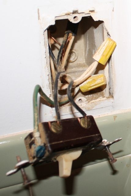

Alright,
I have the new ground fault switch, but there is a challenge... Here's the old switch/box...
But here's the pdf to the specs on the new switch...
http://www.leviton.com/OA_HTML/ibcGetAttachment.jsp?cItemId=FLFCjgfy-K8vFGOPeIW7Pw&label=IBE&appName=IBE&minisite=10251
My guess is that I'll have to remove the caps (with power off of course) and re-wire, but I'm lost on the color coding of the wires. (It doesn't help that when the house was built, they spray painted the walls, and some of the wire looks part white...)
Once again, I'm trying to get a ground fault switch in the bathroom that turns on and off the two sconces, and at the same time have a 120V outlet that is always on...
Thoughts?

Disconnect all wires. With a multimeter or test light (but not a non contact tester) determine which pair of black and white are hot. Connect those to the line side of the switch.
Connect the remaining white to the silver load side of the switch.
Connect one of the switch wires to the brass load side of the switch.
Wire nut the remaining switch wire to the remaining black wire.
Connect grounds together and pigtail to the switch.

Hi Ray2047,
Perfect! Works like a dream...
