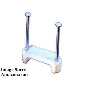

Yes, NM-B. 14/2. Is that no good?Can I run the wires through the beams and using wire nails?

I don't know if 14-2 NM-b is good because you haven't told me the size of the breaker. As long as it is not run outside it is good. You should use staples or plastic cable clips to secure the MN-b not nails. If staples be sure you don't drive them so tight you damage the cable. I recommend plastic clips because you are less likely to damage the cable.
