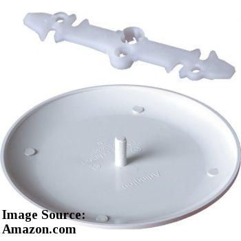

Rays sketch is exactly what you need to do, with one minor difference. When you remove the existing light, you need to have the wire to it end in an electrical box. That is where you splice the new wires to the existing ones. You can splice two lengths and run one to each light. or run to one light and then across to the other. Usually easier to do that but it really doesn't matter.
What does matter is that the box where the old fixture is removed must be both closed and accessible when you're finished. That means that it must have a blank cover on it and that that cover must be visible when you walk into the room. The means of removing the cover must also be visible.
If that doesn't suit you or your #1 customer, you can pull a new cable from switch #2 to the first can and abandon the existing wiring.

Here is one type of blank cover you can use over the box:

And that is the problem. You can't remove the junction box. It must remain. You can replace the light with a blank cover (sse post #16) and paint the cover to match the wall.
If there is an accessible unfinished attic above there is a third way that may work but I haven't mentioned that to avoid confusion. Simplest is as you suggest come off the light junction box but the box can not be removed.
If there isn't a junction box in the wall behind where the strip light was you will have to install one there to make the splices in if you want to extend the cable that went to the strip light. Why? Because electrical splices are only allowed inside approved, closed electrical boxes. It's a fire prevention, life safety requirement.
There are other ways to do this, as Ray mentioned, if you'd prefer not to have an accessible box remain visible above the mirror.
