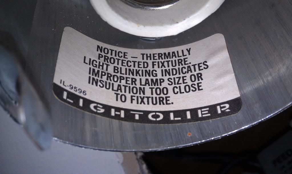

I can seen the junction box but I don't know if a standard LED retrofit will work without a standard can. The socket actually has a notice on it: Thermally Protected Fixture. Light blinking indicates improper lamp size or insulation too close to fixture.

Another reason to dislike Lightolier. That design is similar to larger "architectural" cans I have installed just a few months ago. Those were in a commercial space, and were 8 cans"
PJmax's suggestion is likely the best one. However the thermal device will be near the socket. You could replace that, and then install some LED screw in light bulbs.

The thermal was in the side of the junction box. Look for a black cylinder sticking out of the junction box.

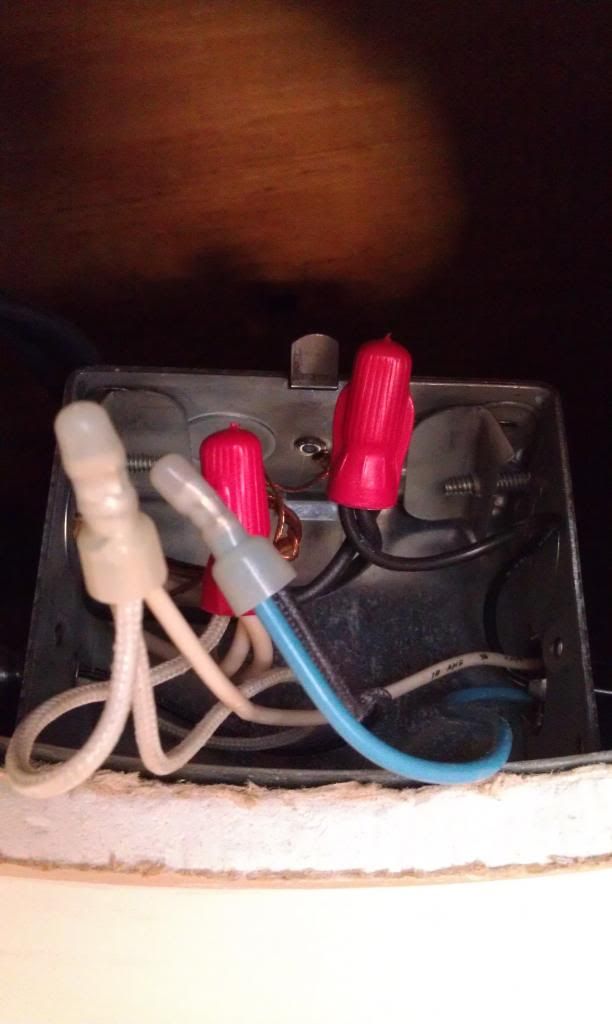

Actually pcboss, I stuck a phone up there and shot a video and I found it. Does it twist out?

It should be mounted to the J-box with a locknut on the inside. Replacing it should require turning the circuit off, uncovering the J-box, disconnecting the wiring and removing the old thermal protector.
"Installation is the reverse of the above."

I have a quick question, looks like the thermal has three wires coming out of it: black, blue, and white. The black wire connector is the standard twist variety but the blue and white are some sort of crimped type. What's the best way to disconnect the blue and white wires? Remove the crimp (I don't currently know how or have a crimp too) or just cut the wires about half way and twist in the new thermal.

Your option. Cut the wires off near the old thermal and splice onto the wires with wire nuts. Or cut off the crimp connectors and replace with wire nuts.
