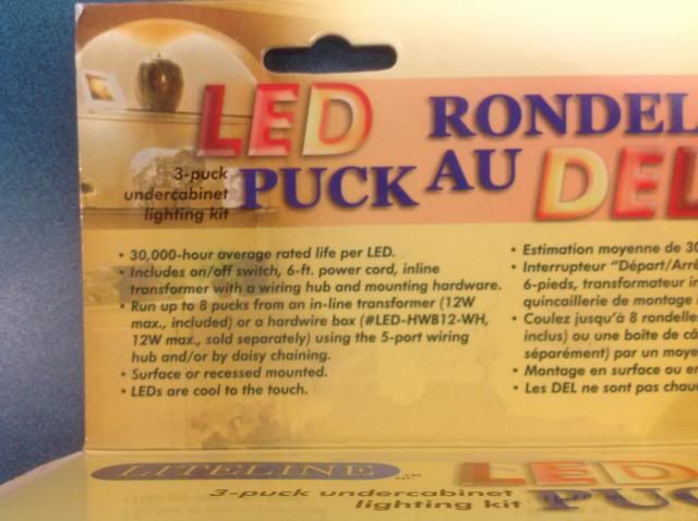

I have some LED lights burning out. They were installed by an electrician about 2years ago and are hardly used. Basement reck room.
Reading the package we are looking at 30,000hrs, break that down I could leave the lights on for about 3 years no problem.
Thanks for any assistance.
Box pics,

Most compact fluorescent lights also have the same problem of life nowhere near the claims. In your case if you read carefully they advertise 30'000 hour average life per LED. They don't say the fixture/system will last that long. They just say that that one component (the LED emitter) has a very long life. There are a lot of other components that go into an LED system so you multiply all their failure rates and you end up with a fixture have a much shorter life span. Generally all it takes is one component to fail and the entire puck or light does not work. Also, the LED is the last component in the system and all the other components upstream bear the brunt of voltage spikes protecting the actual LED emitter.
This is one situation where buying quality can really help. Inexpensive lights are made from inexpensive components and tend to have shorter lives.
