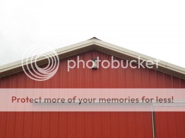

This is where I want to put the lights. This option was suggest but turned down looks horrible and not good at all.
The steel building has no wood 99 % steel .
As for the lights I was thinking of the led version. Or the sealed flood lights .
Thanks

The only reasonable way is to use a piece of wood (treated if you want) bolted to the barn then mounting the light to the wood. If done right it will look and be professional.

I wouldn't mount a light like this just to the metal siding. That's not made to support the weight or provide for a box, if you need one. I would, however, mount it to siding that was backed with framed-in wood that could provide the support for both the light and any needed box.

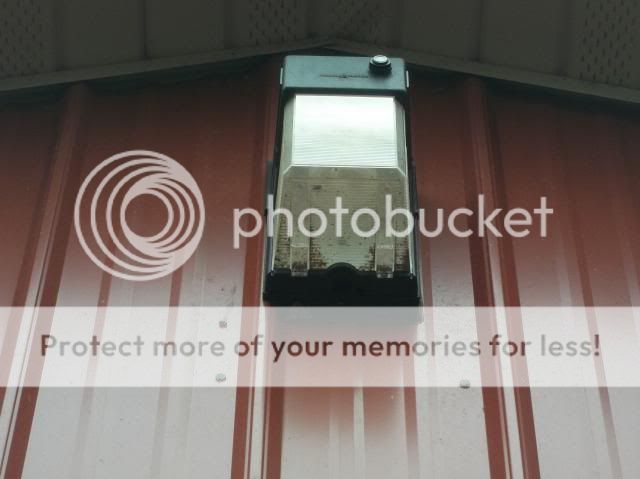

Here is a picture of our barn with, what was a HPS light that crapped out, and now it is a CFL light. (I rewired it ) I cut some wood the same size of the light and painted it the same color of the light. Not how I had to cut one side at an angle. I screwed that to the barn tin but my light is all plastic. PJ's light I think would be pretty heavy hanging out on that arm for just attaching it to the tin.
You have no framing on the inside? I would get some framing on the inside and attach a round weather proof box to that. Then connect your light to that. Although some of the lights like PJ posted just have a cord that comes out the bottom that you run to a weather proof box. Then what you would need is to just attach the arm to some kind of framing on the inside.
IIRC my light was about $25 for the HPS which is a dull orange light. I do like the CFL better which is a 120 watt equivalent and have never had a problem with it working in the winter at -20f. My light is called a wall pack.
