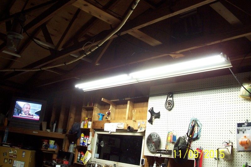

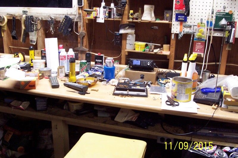

Old 11-09-15, 07:47 PM
B
Join Date: Jun 2002
Location: Northern Minnesota
Posts: 1,626
Received 13 Upvotes on 9 Posts
These Lights Are Terrific
Took the ballasts out and wired them up like Ray said and I couldn't be more pleased, they are bright and white!
Over my bench I have two four footers hooked together (little over 5 feet above bench) and all I can say is amazing.
Here's the messy bench without a flash after dark...
Larry, I tried with one tube in each and I'd say it is a toss up. The light is so much whiter it's hard to tell. So, unless you have an operating table in your shop I think one tube would be satisfactory. Then again you are gettin' pretty long in the tooth so....?
Thanks Ray!
