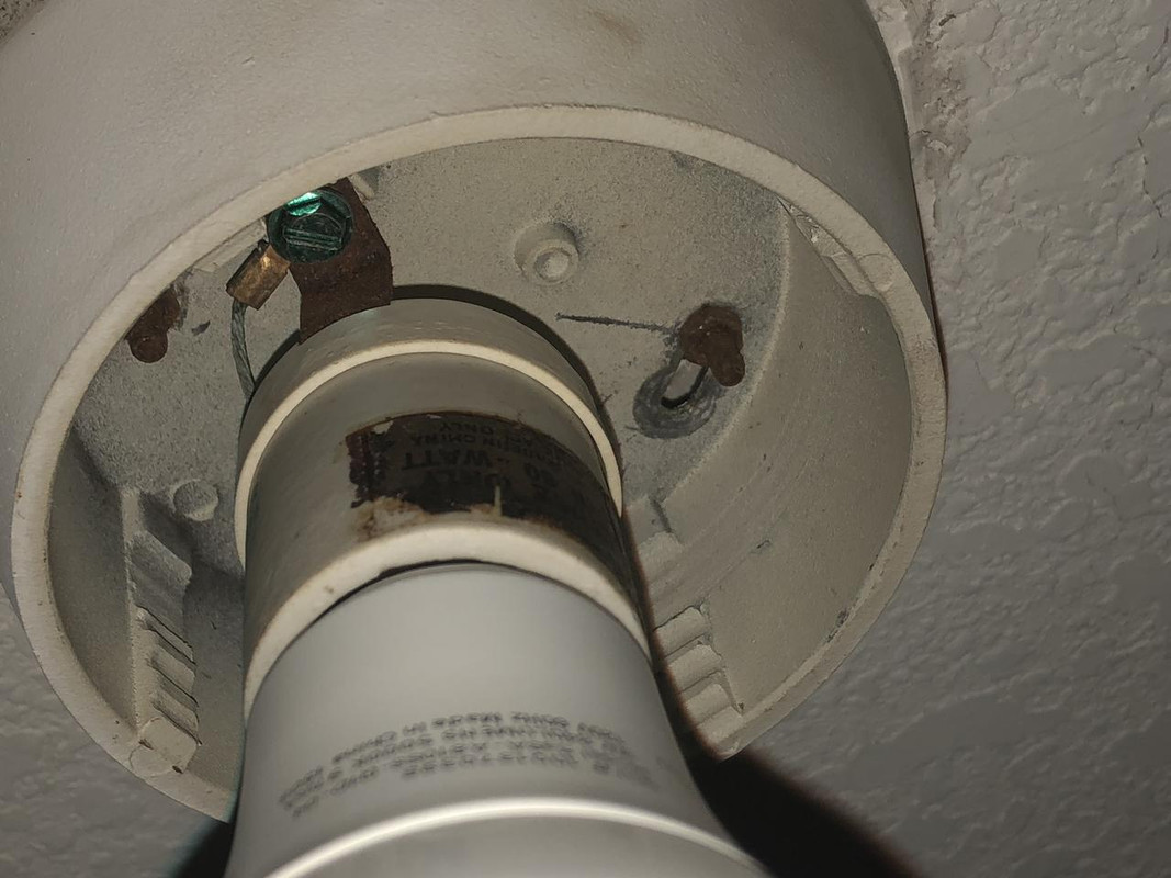

Need help to remove globe ceiling flush mount light
This pic below is of the Flushmount Light I need removed.
This is located on the porch/entrance of my condo and I am not permitted to make changes/cut drywall. I can only remove and replace
<img src="https://s31.postimg.cc/3md18fqmz/image.jpg" width="262" height="320"/>
I am unable to remove the nut from the bolt, the bold spins along the nut when I try to unfasten already tried lubricants, vinegar, rust remover solution etc still the blot keeps sipping anticlockwise when I try to unscrew the nut. I think its just a horrible design even if it was not corroded it would just keep spinning I tested it at a local store. If the bolt head or bolt rod is held firm and the nut spun anti clock on then it unfastened unfastened . but once installed I am not able to figure out how to remove.
<img src="https://s31.postimg.cc/pzkrvg1x7/IMG_1473_1.jpg" width="600" height="800"/>

I'm confused.
If it needs to come down what's the issue?
There never should have been a nut there in the first place but if there is just remove the screw and nut together.

I'm also confused. Maybe the nut is on the other side of the plate? Unscrewing the nut and screw should remove the the whole thing from the mounting plate attaching it to the box.

Did you bother reading my detailed post? What is confusing in my post?
The bolt spins along the nut, it just keeps rotating and does not unscrew
Even I know " There never should have been a nut " I am here to seek a solution, no point telling me what I have clearly described as my concern that needs a solution

Cut it off with a Dremel tool.

OK, calm down. Can you get a grip with a set of pliers or vise grip on the screw head? If so can you turn and pull down at the same time to force the screw threads to catch the tin of the plate? If not then grind the head off and let it fall off then remove what's left of screw.

nope, already tried no room to squeeze in rotory or flat baldes

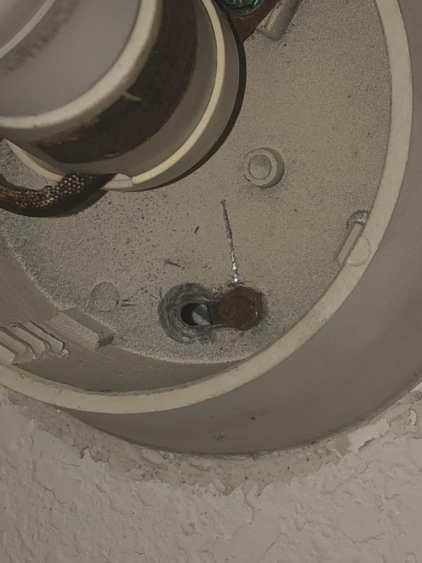

less than 1/2 inch to hold the bolt with a plier . the screw head is on the other side

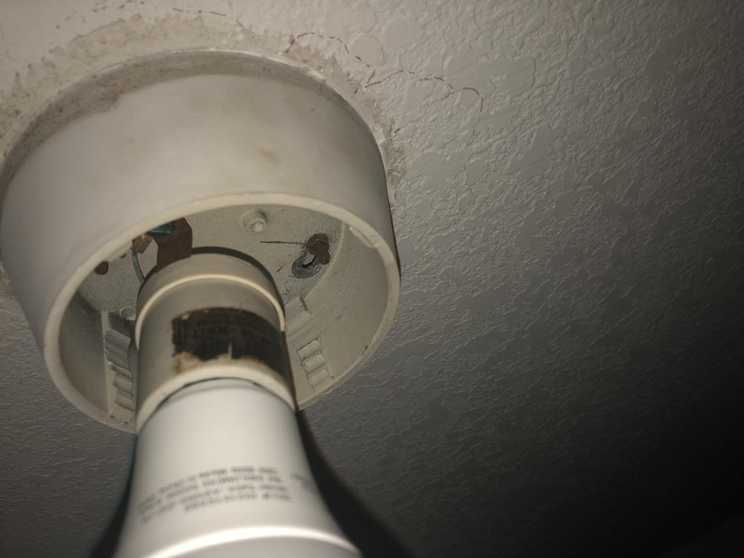

i am adding additional pictures, it may help

First remove the bulb to get it out of the way. From what your suggesting it's likely the screws are stripped, Once the bulbs out of the way pulling down with needle nosed vice grips pulling straight down and turning counter clockwise should get it out.
Once out retap for 10-32 screw.

No the nut is not on the other side, I have added additional pics in the earlier post hopefully it will help visualize
i am unable to unscrew the nut and that is my issue, nut and bot seem conjoint and just keep spinning both clockwise or anticlocwise
The head of the bolt is on the other side, head ideally if acceable could have been used to hold the bolt firm and then one could have unsrewed the nut

You can't get a Dremel tool in there? I've had tighter spaces than that to use one. Try using a rust dissolving solution, such as navel jelly (but I doubt it will work). maybe some type of acid will cut through the corrosion. CLR or Lime-A-Way.

Please ignore the bulb .. I was lazy to get out the ladder .All my previous attempts were with out the bulb in the socket.
Its not a screw, its a bold with the head on the other side (and not accessible)
I have in earlier post responed to another member i dont have any room to put 2 tools at the same time if i put in a
plier/ nosed vice grips i dont have any room to put in a wrench to unscrew

No I cannot get Dremel in - the scratched surface you see is due the failed attempt
You may have missed reading my first post I have tried all rust mitigating solutions I have used every possible agents ( including lime a way)
the corrosion is not the issue at all.
Just imagine this how would one unscrew a nut from a bolt in your hands? Hold the bolt first and then spin the nut anti-clockwise, my issue I can only do one at a time due to the tricky spot i cannot do both in one go

You could use a chisel to try to enlarge the hole around the screws so you could pull it over the screws. Maybe drill a series of holes around the screw first.
Plan B: Cut a chunk out of the lamp base so you can Dremel the screw.
Concerns: You do have access to the breaker don't you? If truly 3 inches new fixtures may not fit. You may need a larger box.

you may have missed seeing the pictures attached in the original post the base is made of very thick metal a chisel is not going to help, cutting the lamp base is simply not possible 1) thick metal 2) risk of drywall damage
I do like your idea of making the the hole size bigger and try to slip it out, that was going to be my last option and was not sure if i was not missing any easy better options

Again, base is made of thick metal... I even tried a Reciprocating Saw but it does not help I have hardly 1/4 inch space left inside the hole the blade have up/down movement and needs at least 1 inch to do any cutting.

That looks like a diecast fixture. Almost like the type used outdoors. You put in a heavy duty square shank screwdriver and turn it with an adjustable wrench. The hole will open or the box will crumble.

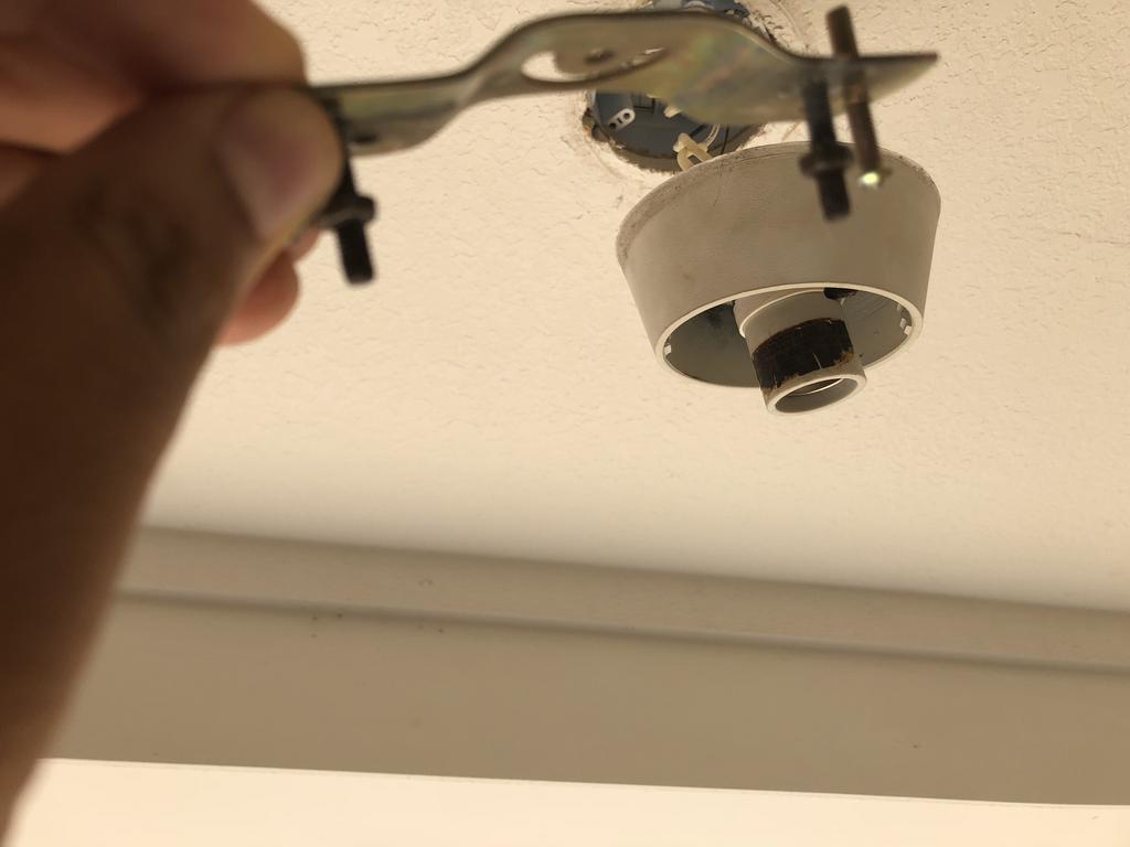

Thank you all....
Finally got it out ....Had to resort to my last option (also ray2047's recommendation) made a bigger hole and pulled it out
between i still cannot get the nut unscrewed from the bolt. This is such a horrible design

I was losing hope and starting to get frustrated with so many different tril and error approaches
30 min of patient drilling to widening the hole and some squeezing pressure down got it our
