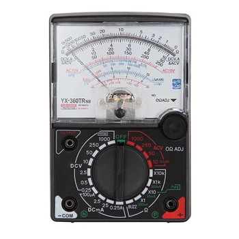

Thanks, I have a multimeter I'll try that before going into the attic. What should I be checking for voltage wise? 120 volt at the fixture? Also what setting should I turn the dial to for 120 volt?
You will be testing for AC voltage. If you have an analog meter (with a needle that moves) set it to AC and pick a voltage number higher than 120. In my photo that would be red ACV 250. On the meter in the photo the needle will come up to about half way when 120 VAC is present. Don't worry about reading what it indicates exactly. If it's something in that area it's telling you that you've found 120 VAC.

The black wires at the switch are showing 123.9 v when the switch is on. When I test the black on the fixture and using the fixture ground or neutral wires I get 0. When I test the black at the fixture using a ground at the switch I get 123.9. So it seems like the neutral and ground are no longer intact. Also, I noticed the sheathing on the switch going to the light is white, and the sheathing at the fixture is yellow. So there must be a junction box somewhere? I recently purchased this house and I’ve noticed a lot of weird things done!
