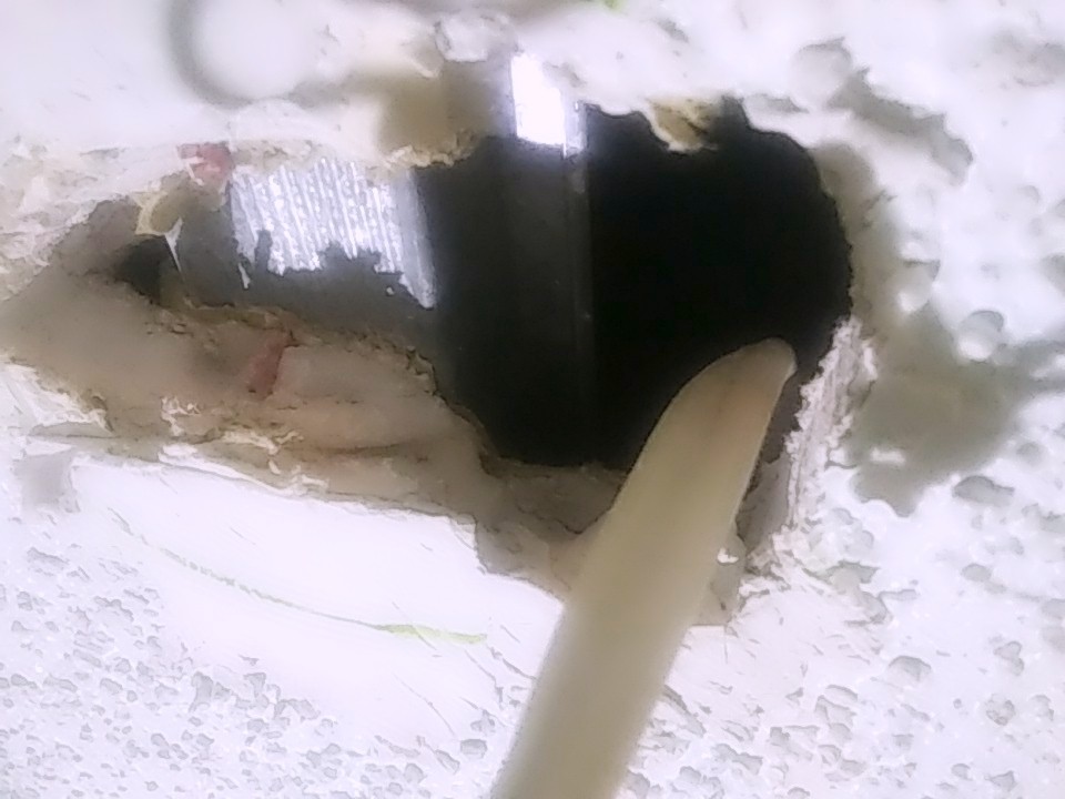

Hello,
I live in a condo over 30 years old and moved in 15 years ago. The fans were already installed when I moved in.
A couple weeks ago I decided to upgrade 3 of the fans. Two of them there was no problem installing with the existing fan boxes were properly installed.
Then I got to the living room. I discovered there was a problem. The fan bracket was directly mounted to the steel joist with the wires just hanging from the ceiling and no box.
I attempted to fix this problem and looked for a solution. On Amazon I found an old work saddle box but the description was very vague. I asked questions and never got an answer. Out of frustration I just purchased the saddle box. Now it arrived and me cutting more around the joist I can tell the opening for the saddle box isn't wide enough for the steel joist.
What is the best solution to install an old work fan box near a steel joist?
PS: I just took this picture showing the opening (I widened it a little) showing the steel joist and wire hanging out of the ceiling.

Welcome to the forums.
That is a particular problem that I've run into it before. I get a piece of wood...... like a short 2x4 and I set it on top of the metal stud where it's parallel to the sheetrock. I use one sheetrock screw thru the metal stud into the 2x4 to hold it in place. Then I use a fan rated pancake box bolted up thru the steel stud into the 2x4. The two holes thru the metal stud and into the wood need to be pre-drilled so as not to crack the wood.

That is likely metal furring strip often called Hat Track (https://www.homedepot.com/p/ClarkDie...B&gclsrc=aw.ds) I would recomend only using the steel pancake box that PJ posted.

The problem with track is it's not thick enough to hold the screws from the box. It still needs added material above it. I'm guessing that track is fastened to the bottom of joists that you may just be able to see in the hole.
